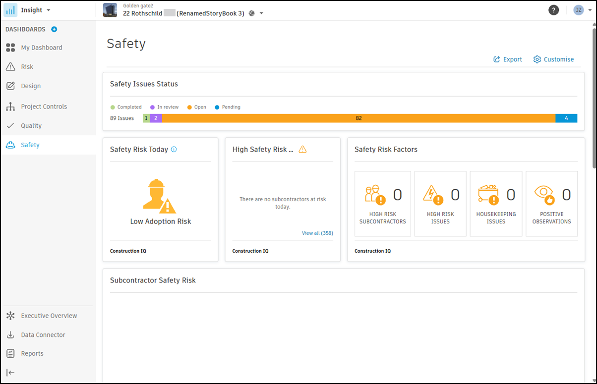

Safety data is primarily displayed in the Safety feature:
The Safety tab can include data such as:
A Subcontractor Safety Risk grid, which shows the number and type of safety issues assigned to each subcontractor over a specified length of time.
The grid provides a visual overview of the subcontractors with the most safety issues assigned to them and the severity of the issues. This can help project managers to focus on the areas that need most attention.
Positive Observations and Safety Observations cards, which show the number of observations listed for each subcontractor over a specified length of time.
Safety Risk Factors, which shows the contributing factors to a project's daily safety risk rating.
