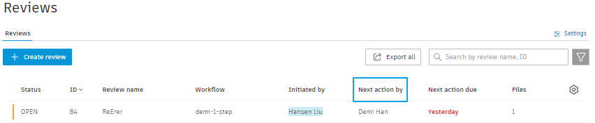

  1. If you received a notification email, click on the View Review link at the bottom.
    Alternatively, open the Reviews tool and click on the review with your name, role or company listed in the Next action by column:
    Tip: Click the column headers to sort the reviews, use the search box to search for a review by name or ID or use the filter button to use filters including:

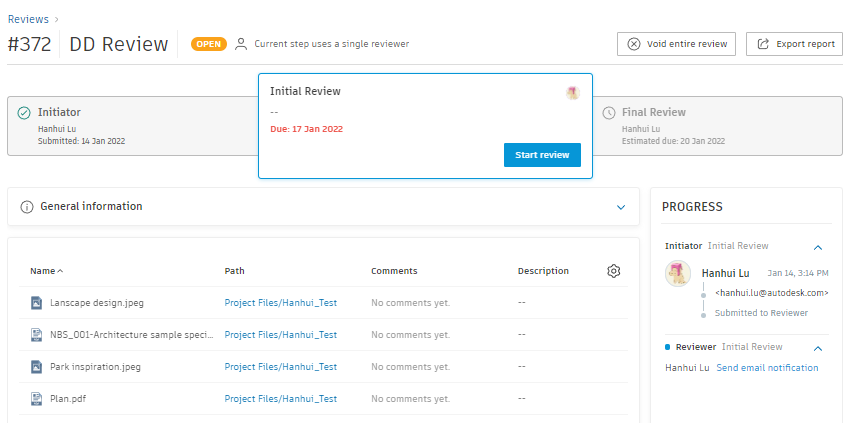

Complete an Initial Review
  1. Click Start review and confirm that you want the review to be assigned to you.
    • If you are a reviewer, this will start the initial review(s).
    • If you are an approver, this will start the final review.
    Note: Only the specified reviewers and approvers, or a project administrator, can start an initial review and assign it to themselves.

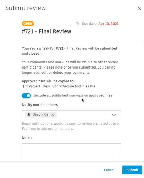

  6. Click Submit review.
    Note: If the review files are locked and they've been renamed or the custom attribute values are edited during the review, then the files can't be submitted at the final step with the relevant changes until the relevant member, or a member with Manage permission or above, has unlocked the files.
    If the approval workflow allows the approver to choose whether or not published markups on approved files copy to the target folder, you can decide at this stage by toggling Include all published markups on approved files.
    If the approved files are new versions of existing files in the target folder, markups from the previous file versions and from the review will both appear on the approved files.
  7. Click Submit.

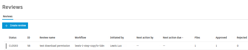

    The review is displayed in the Reviews tool and is marked as CLOSED. The total number of files included, approved and rejected is displayed:
    Tip: Click a closed review to open the Review detail page. Here you can see a record of the review progress and details of each file including, if applicable, the folder that each approved file was copied to. You can also click Export report to download an Excel spreadsheet containing the review details and any comments made during the review and approval steps.
