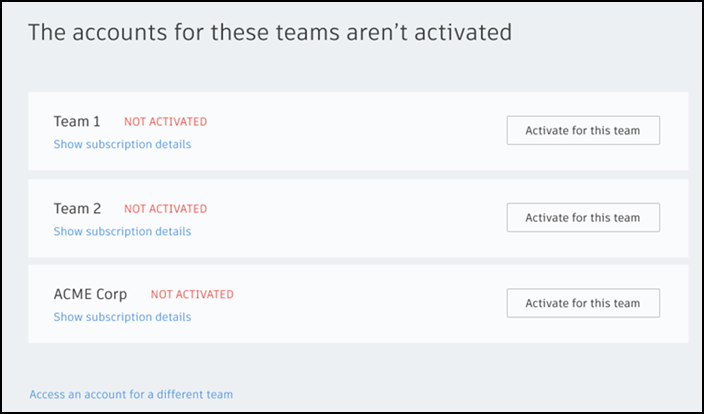

  4. If this is your first purchase for this hub, you'll see that the hub isn't active yet. Click Activate for this team.

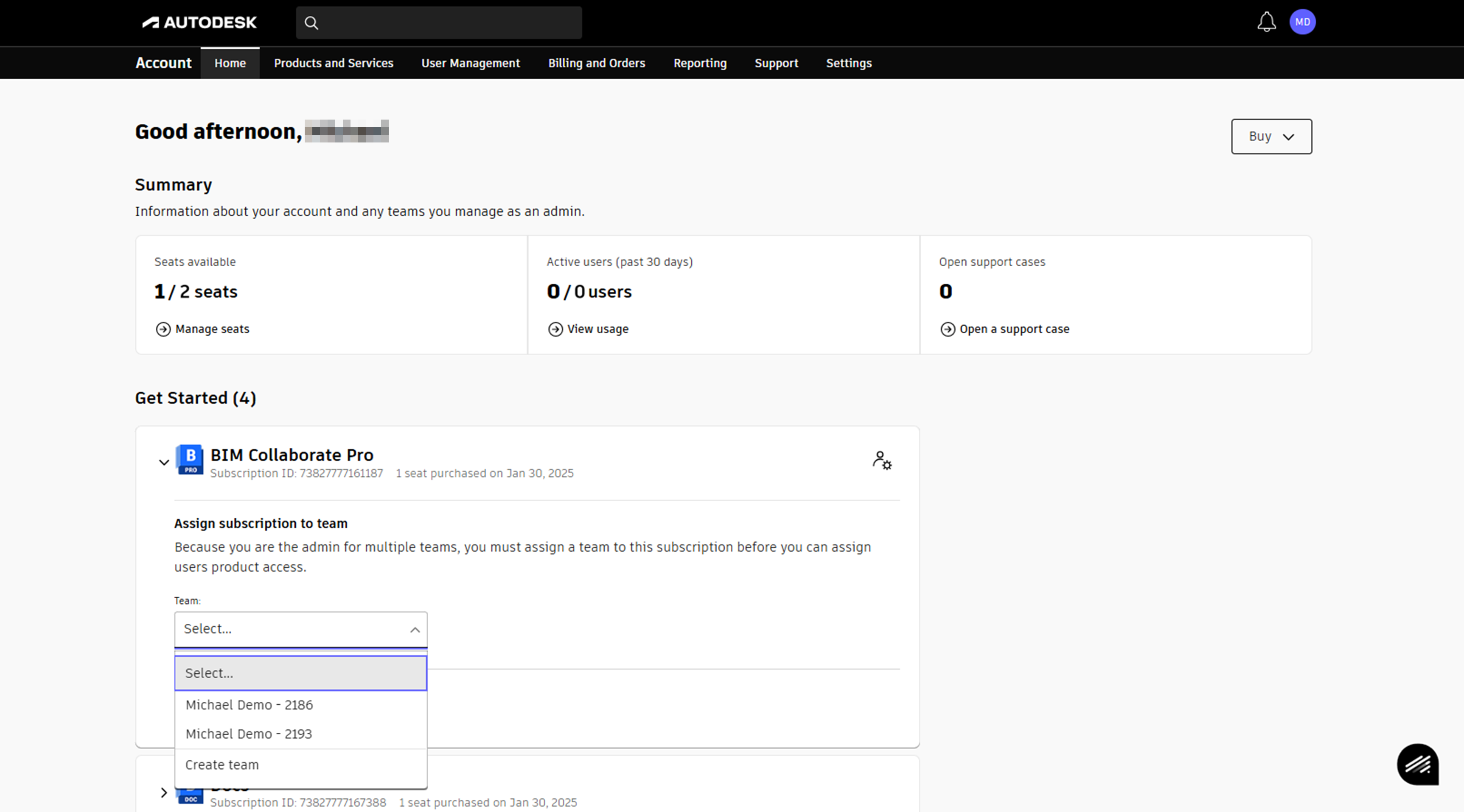

Assign a Subscription to a Team
If you've purchased Autodesk Forma™ products for you or your organisation, and your organisation's hub has multiple teams, you must assign the subscription to a team.
  1. Navigate to the Autodesk Hub and sign in.
    Tip: If you purchased products through the Autodesk eStore, you can click the Access In Your Hub link from your order confirmation screen, or Access Hub from the confirmation email.
  2. Click Home to be on the home page.
  3. Select a team to assign your subscription to using the drop-down list.
Assign Team
Once this has been completed, you can follow the workflow in the Activate a New Hub section starting at step 2.

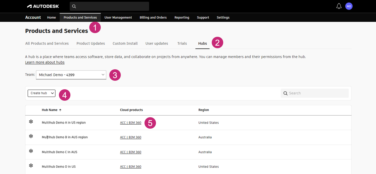

Hub Admin in Autodesk Forma allows you to see and work with a Hub from manage.autodesk.com. If you need to have data stored in multiple data regions, you need to create multiple hubs. Hubs can be created or accessed from the Products and Services tab in manage.autodesk.com.
Hubs page
  1. Products and Services tab
  2. Hubs tab
  3. Team selection drop-down list (only available if you have multiple teams)
  4. Hub creation
  5. Link to access your hub in Autodesk Forma
Important: If you have an active Enterprise Business Agreement (EBA), contact your Autodesk hub team for support in creating an additional hub.

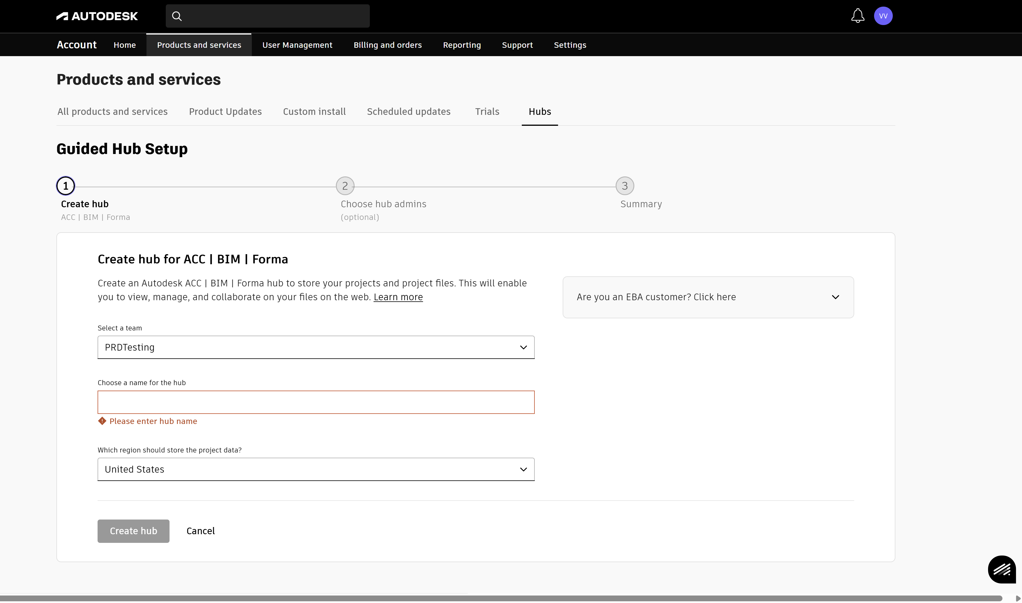

  3. Select Create hub. This opens the guided hub setup experience that walks you through naming your hub, selecting the data region and adding administrators.
  4. Select the team to host the hub, enter a hub name and select the data region for the hub. Then select Create hub.
Create Hub Setup Experience Step One

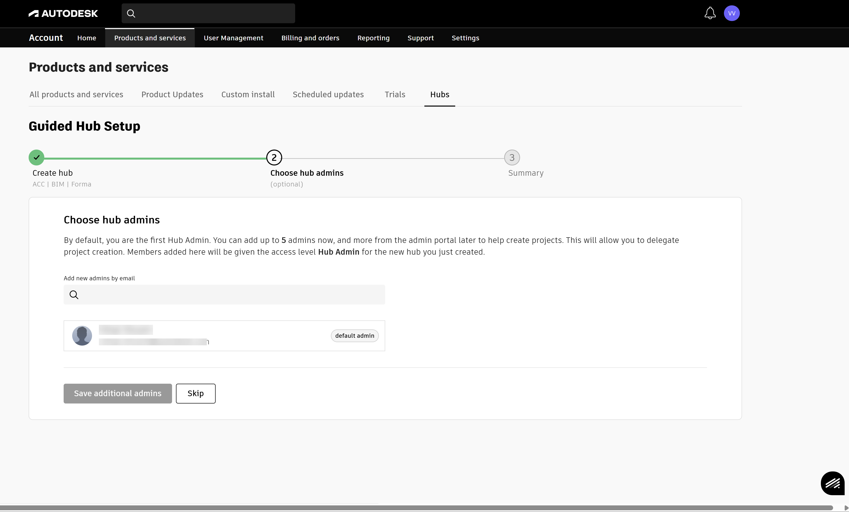

  1. Add more administrators to the hub. Allow others to manage the projects and members in the hub. You can add administrators now or skip this step and add them later from Hub Administration.
Create Hub Setup Experience Step Two

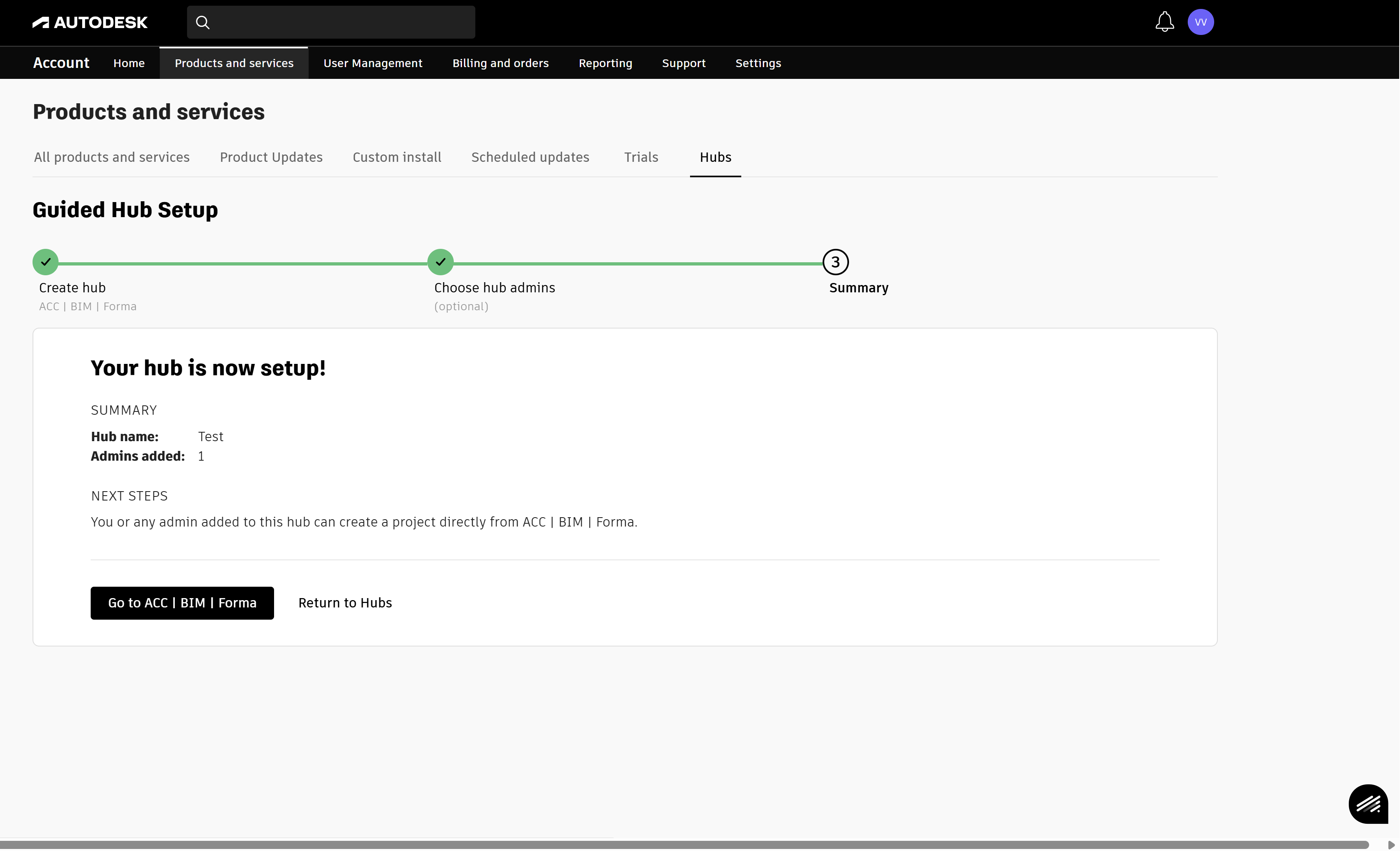

  1. Review the hub details. Then select Go to ACC | BIM | Forma to create projects and manage your hub or Return to Hubs to view your list of hubs.
Create Hub Setup Experience Step Three
