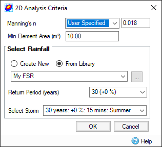

The 2D Analysis Criteria has the following dialog:
The 2D Analysis Criteria dialog requests a number of values:
Manning's n – The Manning’s n roughness value of the site to be assessed. This can be selected from a predefined list or user specified.
Type
Manning's n
Urban 0.018
Mixed 0.030
Rural 0.100
Minimum Element Area – The smaller the minimum element area, the more accurate the analysis but the longer it takes.
Rainfall Set – Select a rainfall set from the Rainfall Manager.
Note: For phases containing only Baseflow or Input Hydrographs, the Rainfall set will be disabled.
