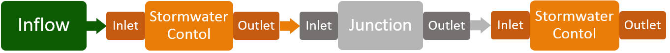

Alternatively your first click on Plan can be on an existing item. This will start the train at the existing item (regardless of the next item shown on the Build ribbon) and subsequent clicks will follow the Train sequence of adding Junctions and Stormwater controls (SWC) depending on your selection.

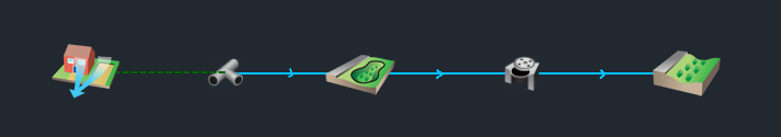

Drop SWC
This mode will place a SWC at the location clicked on Plan. Connections are added automatically to connect the new SWC to the previous one using the last selected template on the Build ribbon or Toolbox. This can be updated during the Add Train mode. The figure below shows a simple Train created in this mode.

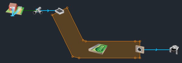

Outline SWC
This mode will place a SWC at the location clicked on the Plan and show an outline for you to layout the SWC area. Your second click marks the end of the SWC. The figure below shows a Train being created in this mode. The width of the outline, specified by the Outline Width field, can be changed on the Build ribbon. If the next item to be placed is a Junction, Outline SWC mode acts as Drop SWC mode.

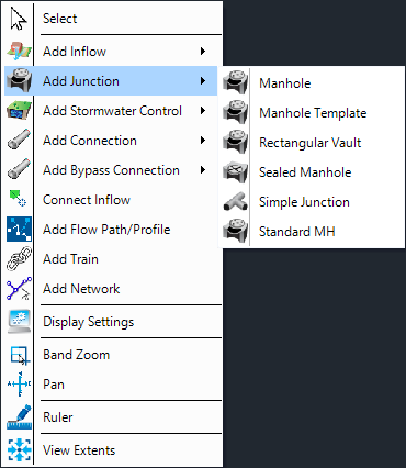

The right-click menu on Plan (below) lists the items available to be placed, this menu changes depending on the valid items that can be placed next in the sequence. You can change the Next Item using this menu, the Build ribbon or the Toolbox. Clicking Add Junction, for example, requests that the next item placed is a junction.

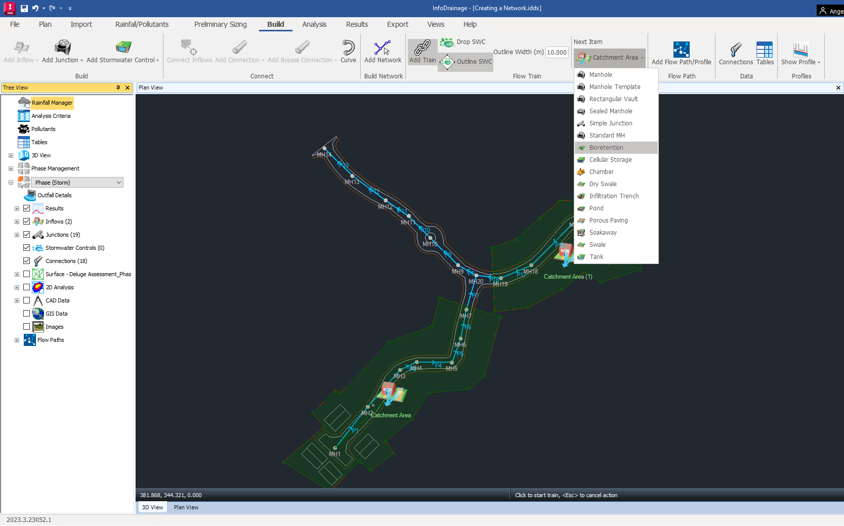

There are two ways to select the Next Item to be placed using the Build ribbon:
