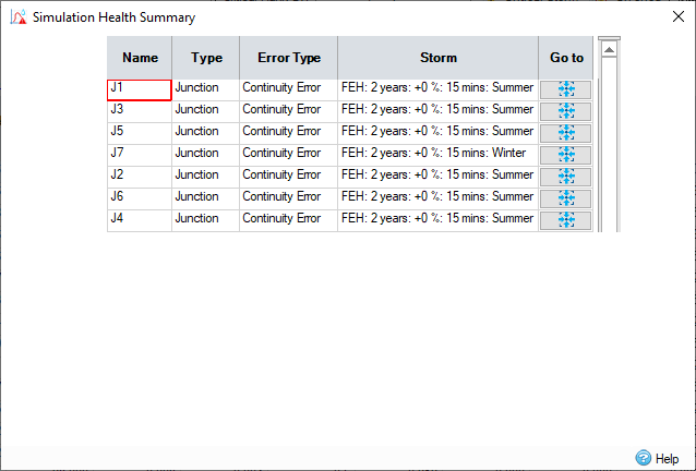

The Simulation Health Summary table provides detailed information on the type of error for a given junction, inflow, stormwater control or connection. It also provides a percentage value of the error, error count and the storm event the error applies to, among other information.
Name – The name of the junction, stormwater control or connection that this error refers to.
Error Type – The type of error. For more information about error types, go to Simulation Health.
Storm – The storm event that this error is applicable to.
Go to – Click this button to move the plan view to the item with the error. When clicked, it changes the storm to the one listed in the Storm column.
