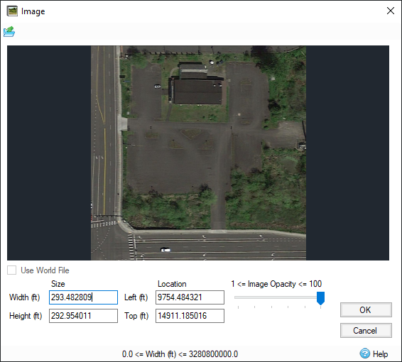

The first step will be to locate the image you wish to load using the Open dialog. Once selected you will be presented with the Image Import form, which shows a preview of the image together with the location and dimension. These locations can be automatically populated via the use of a World File that is associated with the image to provide Geo-referenced data.
Width – The width of the image when drawn on plan. By default this will be set to fill the current plan view.
Height – The height of the image when drawn on plan. By default this will be set to fill the current plan view.
Left – The left of the image when drawn on plan. By default this will be set to the left of the current view on Plan.
Top – The top of the image when drawn on plan. By default this will be set to the top of the current view on Plan.
If a World Files is found when an image is loaded, its details will be used to populate the Size and Location fields in the image import dialog. The World File details will be used by default. However, it is possible to overrule them by clearing this box and manually entering the values.
Set the opacity of the image. This will allow to handle overlapping images as well as making it easier to see CAD/GIS data if needed.
