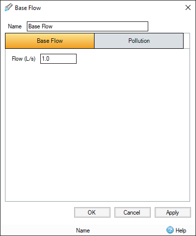

Base Flow
A constant flow can be applied to the system using the Base Flow Inflow type. A Base Flow is a simplified input hydrograph. The Base Flow type can be selected from the Build Ribbon or from the Toolbox under Inflows.
Runoff
Note: In Foul phase the pollution tab is not available.
Flow
A constant flow rate.
