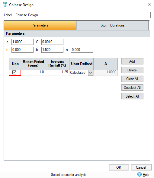

Parameters
a
Equation constant, used in calculation of A when calculation of A is set to Calculated
C
r
The portion of the duration of the event occurring before the peak
r value examples:
place
r(times)
area
r(times)
Chicago
0.375(83)
Beijing
0.355(57)
Soviet
0.35(–)
Shanghai
0.367(80)
Japan
0.50(1050)
North China
0.3–0.4(483)
Most Chinese city
0.3–0.4(–)
Wuhan
0.3–0.4(–)
b
User-defined equation constant.
n
Return Period
Period, in years, between events of the same intensity or of a greater intensity than this storm.
Increase Rainfall
This will scale all rainfall by the amount specified. This can be used to take climate change, or other factors, into account.
Calculation of A
Select method of specifying value of A:
A (Calculated)
A is calculated as:
a(1 + Clog10P)
Where P is return period.
A (User)

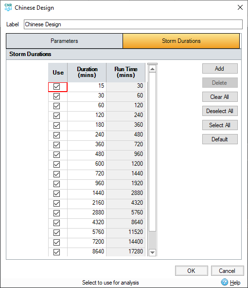

Storm Durations
A set of Storm Durations and run times must be specified for the analysis to run back to back. All duration values can be edited, and new rows can be added for additional durations.
