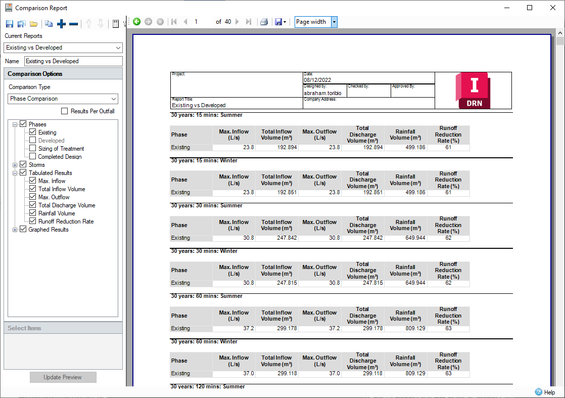

Report Management
Reports hold a single comparison as defined by the user. Multiple reports can be created, and on updating the preview are displayed in the desired order. Reports are saved locally within the site, and will be recovered as best as possible when re-opening the form after making changes and re-analysing the site. Any phases, storms or nodes that no longer exist will be removed from the report when it is loaded.
The drop-down menu can be used to select a different report, which will populate the Comparison Options as seen below. The name textbox allows you to enter a unique name to identify the report; this will be shown at the top of each page of the report.

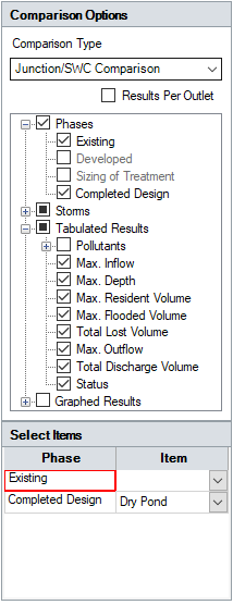

Comparison Selection
Selection of items is done in the Comparison Selection box. From here the Comparison Type must be selected, which will filter the rest of the options available, irrelevant graph or result selections are removed from the displayed options.
The tick box for Results Per Outlet will increase the information for a Junction or Drainage System to include component outflows per outlet. The same option, when in a Phase-to-Phase comparison, is instead labelled Results Per Outfall, which separates all the outflows leaving the system by their Junction or SWC.
Phases and storms can be selected for all comparison types. The storms node also contains the Critical Storm node. Note that you cannot graph the Critical Storm, and a report with only the critical storm and graphs selected is therefore invalid. The storm selected for the 1D/2D analysis is not available for selection.
Tabulated and Graphed results will vary depending on the selected Comparison Types. Any pollutants that are present in the site will be available for selection when doing a Junction/SWC comparison. Pollutants can be selected separately for Graphing and Tabulation.
If not doing a Phase-to-Phase comparison, the individual items per phase must be selected. Only one item can be selected per phase. Multiple phases are not required for a report generation.
