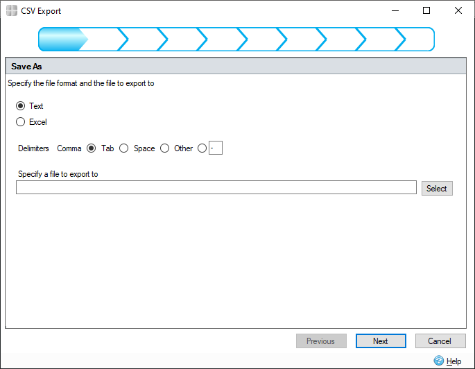

1. File Selection
This step allows you to specify the type of file to be written and to specify the file by pressing the Select button.

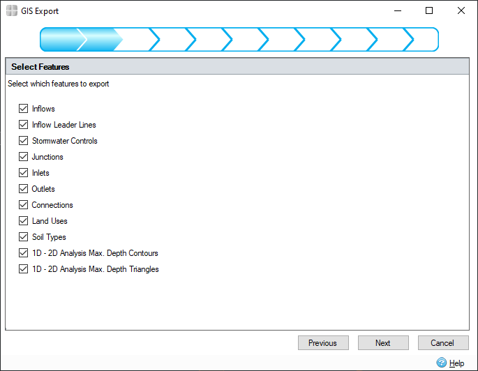

2. Feature Selection
If a feature type that contains multiple feature types to be exported (for example, Phase) has been selected for export, this step allows the user to select the features that will be exported. The selections here will modify the remaining number of wizard steps.

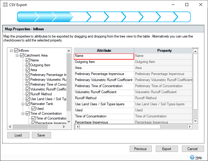

3. Property Association
The wizard will display to the user a property-mapping step for each feature type being exported. Associated non-spatial information called attributes can be exported with each geographic feature. For example, a collection of manholes may be exported with their names, depths and diameters.
This step shows a control that allows the InfoDrainage properties to be mapped to columns in the exported files. The left-hand side of the control shows a tree view of the properties in the object that will be exported. The right-hand side of the control shows a table of attributes that will be written.
To make an association, a property can be dragged from the properties tree view and dropped in the attribute grid. Alternatively, simply tick the required tree node. To remove an association, untick the tree node.
When an association has been made, if the property selected has units, the units column in the attribute table will be populated with a combo box, containing possible units for the attribute values. On export, the attribute values will be converted to this unit from the currently selected unit in the software.
After initial setup, the current association configuration can be saved by pressing the 'Save' button, and a previously saved configuration can be loaded by pressing the 'Load' button.

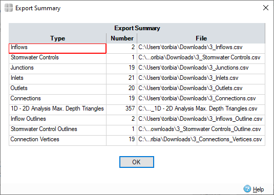

At the final step of the wizard, pressing the 'Export' button will perform the export and create the file(s). When this operation is complete, you will be shown a summary of the objects exported.
