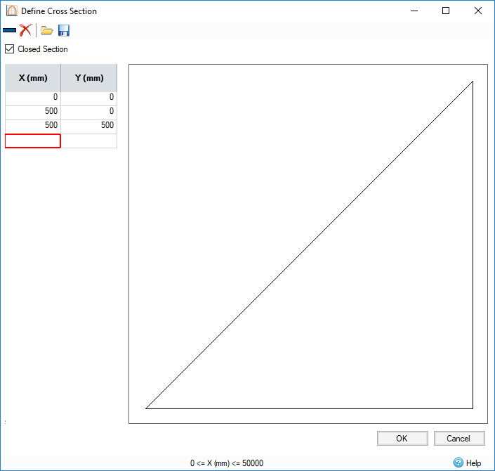

Input coordinates will be validated on leaving the form. Please ensure all coordinate sets obey the following rules:
Finally, the input shape must be closed for Chamber's, which is set automatically. However, Custom Connection may be open or closed depending on the tick box.

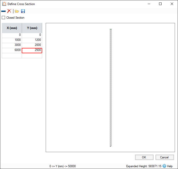

Open Cross-Section
An open Cross-Section works differently to the closed as it has to match the rules of a Channel whilst still being "Custom". To fit this criteria, the Cross-Section preview changes to show the Cover Level (denoted by the green line) and will automatically expand the Cross-Section to reach this Cover Level (where the shape has been expanded is shown by the dotted lines). In the toolbar, under the OK button, there is Expanded Height which shows the Height that will be taken when analysing. This Expanded Height is calculated based on the size of the Cross-Section + Height to reach Cover Level.
