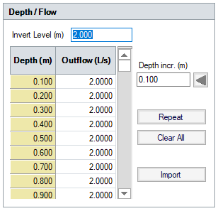

Invert Level – The invert level of the control.
Spreadsheet – Enter the required flow rate for each depth of water.
Depth Increments – The depth increment can be set by entering the required increment into the Depth Incr. field and clicking the Apply button (arrowhead).
Alternatively, the depths and outflow rates can be entered freehand into the table.
Note: Below the first increment of Depth, interpolation of the Flow down to 0 will be calculated. Above the last increment of Depth, the last value for Flow will be repeated.
