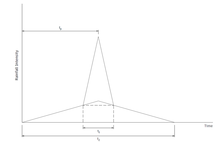

The Desbordes Rainfall refers to the double-triangle hyetograph that was proposed by Prof. Michel Desbordes (Université de Montpellier, France) in the late 1970s. One key principle behind the approach is that the rainfall hyetograph is not trying to replicate observed rainfall patterns, instead its characteristics are derived from a sensitivity analysis of the response of a simple linear reservoir model. The shape of the double-triangle hyetograph aims to reduce the number of sensitive parameters to a minimum. This design rainfall method is the most commonly used in France for hydrological modelling of urban catchments.

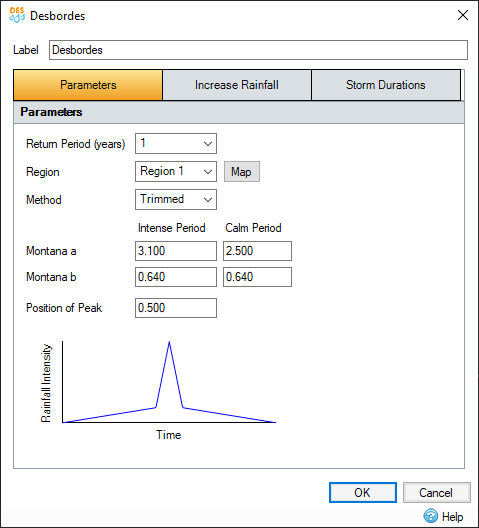

Parameters
Return Period (years)
The software contains the Montana coefficient values for the four return periods specified in the original guidance document (Instruction Technique 77) – 1, 2, 5 and 10 years. However, 'Custom' can be selected to enter your own return period if you wish to enter your own coefficient values for another return period.

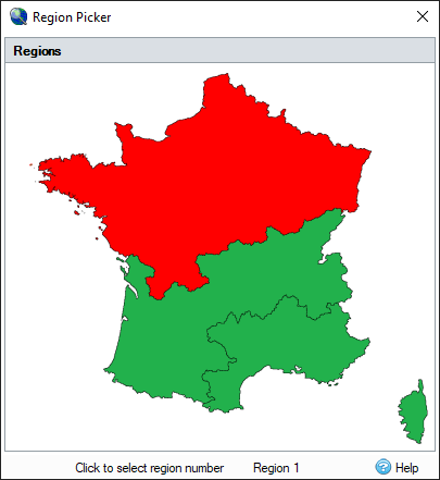

Region
Select which area of France the site is located in (according to the subdivision shown in the Instruction Technique 77). The Map button allows this to be selected graphically by hovering over the region required and left-clicking.
French Region Picker
Method
Allows you to pick the intense period starts, as follows:
Coefficients a and b
There are two sets of a and b coefficients, one for the shorter, intense period triangle and the other to describe the overall duration triangle. These are automatically assigned for the built-in 1-, 2-, 5- and 10-year return periods (as given in the Instruction Technique 77), for other return periods they need to be entered manually. However any value may be over-typed if a known value(s) has been supplied, most likely from Meteo France. The calm period values for a and b default to values approximately equivalent to a 0.5-year return period.
Note: Note the convention for the sign of b: b is considered a positive value.

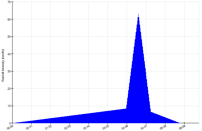

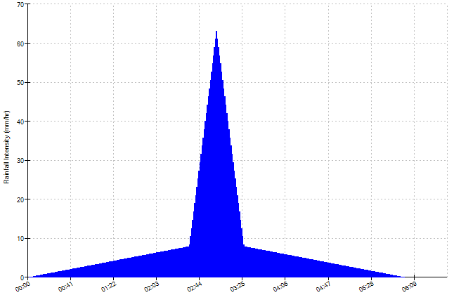

Position of Peak
This parameter describes the position of the peak of the intense period triangle within the whole event duration. By default a value of 0.5 is selected which means that the peak is in the middle of the storm (symmetrical hyetograph). The specified value applies to all the selected durations.
Two example rainfall hyetographs. The first for a position of peak value of 0.5 the second of 0.75.

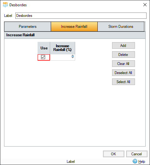

Increase Rainfall
This will scale all rainfall by the amount specified. This can be used to take climate change, or other factors, into account.

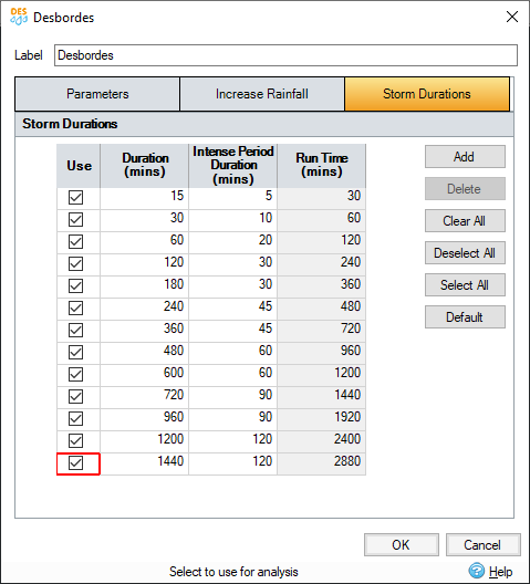

Storm Durations
A set of Storm Durations and run times must be specified for the analysis to run back to back. All duration values can be edited, and new rows can be added for additional durations.
