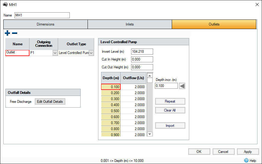

Level-Controlled Pump
Level-Controlled Pumps are similar to the standard Pump control except Cut In and Cut Out heights are specified as well as its own performance curve.
Invert Level – Enter the invert level for the pump.
Cut In Height – Enter the depth from invert level that will start the pump.
Cut Out Height – Enter the depth from invert level that will stop the pump. This should be below the Cut In Height.
Spreadsheet – Enter the required flow rate for each depth of water.
Depth Increments – The depth increment can be set by entering the required increment into the Depth Incr. field and clicking the Apply button (arrowhead).
Alternatively, the depths and outflow rates can be entered freehand into the table.
Import – Data can be loaded from .TXT, .CSV or Excel file using the Import option, which utilises the Universal Importer.
