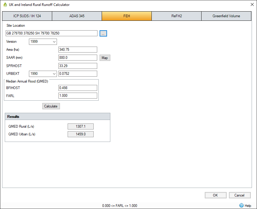

Input Variables
Site Location – Click the dotted button to import the FEH rainfall details. The Open FEH Details box will appear. Locate the file that was exported from the FEH CD or web service and open it. This descriptive field allows the site location to be recorded. If the FEH details are imported from a .csv/xml file, then this field is filled in with the grid reference details.
Note: CSV files from the web service cannot be loaded as these do not contain all the information required by the tool.
Area – Catchment area (km²) converted to ha.
SAAR – Standard average annual rainfall 1961–1990 (mm). This can be loaded in by selecting the Map button and choosing the Site location.
SPRHOST – Standard percentage runoff derived from HOST soils data.
URBEXT – The extent of urban and suburban cover. Either select the 1990 or 2000 values if available, or simply enter a user-defined value. Note that the year 2000 values are only available if using the FEH CD-ROM Version 2. If values for 1990 or 2000 are zero, please check the values as they may not be available from the FEH data.
BFIHOST – Baseflow index derived from Hydrology of Soil Types (HOST) soils data.
FARL – Index of flood attenuation due to reservoirs and lakes.
Note: Note that these values are also imported from the details from a .csv file as created by the FEH CD-ROM software package.
Output Variables
QMED rural (l/s)

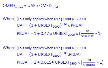

QMED urban (l/s)
The median annual maximum flood is calculated using the formula below (equation yields m³/s):
Note: If the urbanisation is to be increased and this is measured manually in accordance with the FSR (method 1 above) then the proposed URBEXT can be estimated from:
