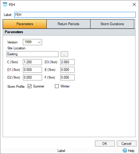

Version
Select either 1999, 2013 or 2022.  With the 1999 option, the six site constants can be typed in. 2013 and 2022 data can only be loaded in from a valid csv/.xml file and displays ‘Point’ or ‘Catchment’ based on the data in the file. If a file loaded does not contain 2013 and 2022 data, then the option is disabled.
Site Location
This descriptive field allows the site location to be recorded. If the FEH details are imported from a .csv/.xml file then this field is filled in with the grid reference details.
FEH 2013 and 2022 results must be limited to a minimum of 2-year return period because the model has not been fitted for return periods below 2 years.
The Load button is used to import the details from a .csv/.xml file as created by the FEH CD-ROM software package. It will import the site location and the six constants as described above. In order to create the file, start the FEH CD-ROM program and follow the instructions below.
Note: The FEH methodology is not recommended for storm durations of less than 30 minutes and is therefore generally unsuitable for use with the Modified Rational Method.
Required Constants
By specifying the six required constants C, D1, D2, D3, E and F rainfall depths can be calculated for different locations in the UK and Ireland.
Summer/Winter Storms
Both the Summer 50 Percentile Profile and the Winter 75 Percentile Profile are supported. The shape of the winter profile is based on applying Lagrange Interpolation to the published CRP values (see Flood Studies Report). Either or both can be run.

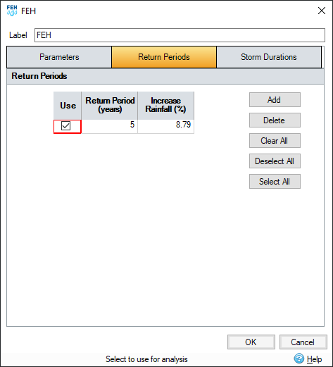

Return Periods
Return periods from 1 to 1000 years are provided.

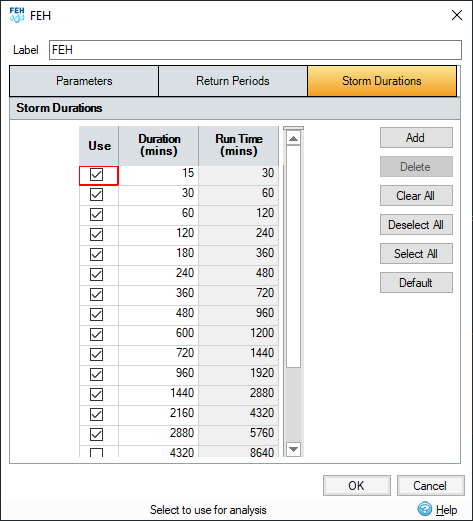

Storm Durations
A set of Storm Durations and run times must be specified for the analysis to run back to back.
