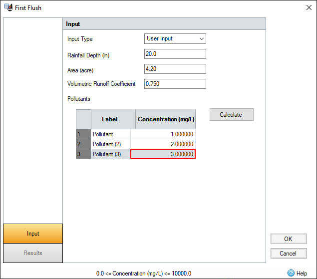

The user is given two main options for calculating the pollutant load:
1. If User Input is selected then the user enters values for:
When the Calculate button is clicked, the total volume is calculated as:
V = A.P.Cv
and the resultant pollutant load lp, for each pollutant p is then calculated as:
lp = V.cp

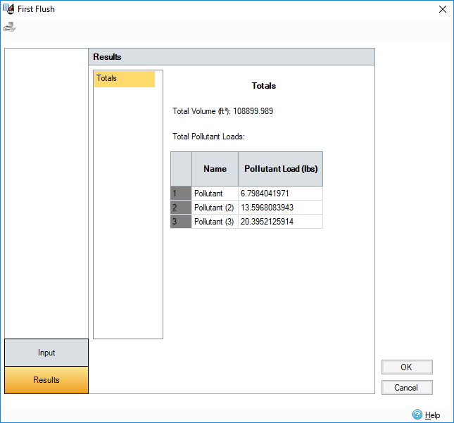

The calculated total volume and pollutant load values are then presented as a table under the ‘Reports’ tab, see Fig. 1 below:
Fig. 1: An example set of inputs for User Input, and the calculated results under the Reports tab

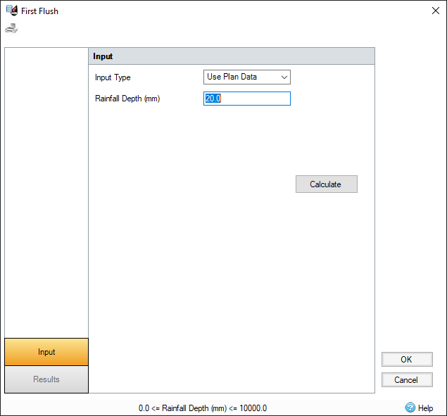

2. If Use Plan Data is selected then the user only enters a value for rainfall depth, P.

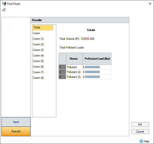

When the Calculate button is clicked, the calculator calculates:
see Fig. 2 below.
The user can then select, from the list on the left-hand side under the ‘Reports’ tab, whether they wish to select the Total volume and pollutant load, or a particular Inflow node’s volume and pollutant load.
For each Inflow node, its volume is calculated depending upon its Runoff Method (in italics):
For a hydrograph, the rainfall depth from the ‘Inputs’ tab is ignored, the volume of a hydrograph is the area under the hydrograph’s flow vs. time graph.
Fig. 2 An example set of inputs for when Use Plan Data is selected, and the calculated results under the Reports tab
