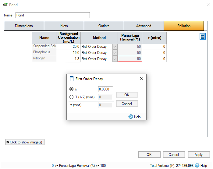

 = the decay constant, which can be specified in a number of ways:
Where:
τ = the decay time constant or (mean) lifetime
T1/2 = the decay half-life
Generally τ is easier to estimate and more likely to be entered by the user. However, the calculator can be used to enter T1/2 or if preferred.
First order decay – with background concentration
Realistically some pollutant concentrations are not reduced to zero. Users are able to specify a background (minimum) concentration (Cback) below which the pollutant concentration will not be reduced.
The method is the same as for First order decay – without background concentration – other than the ability to enter Cback.
