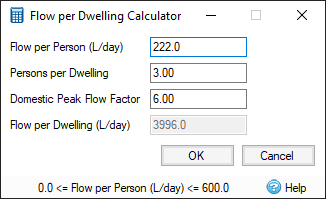

Flow per Dwelling Calculator
The Flow per Dwelling Calculator can be used to set the Flow per Dwelling property of a Foul runoff using the following calculation:
Flow per Dwelling = Flow per Person X Persons per Dwelling X Domestic Peak Flow Factor
Flow per Person – The average flow contributed by a single person.
Persons per Dwelling – The average number of persons occupying a single dwelling.
Domestic Peak Flow Factor – A scaling factor to account for peak flows.
