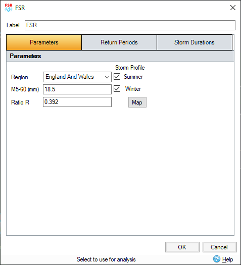

Parameters
Region
England and Wales or Scotland and Ireland
M5-60 (mm)
This is the rainfall depth (specified in mm) for a 60-minute storm with a 5-year return period.
See Fig A.1. of 'Design and Analysis of Urban Storm Drainage' – The Wallingford Procedure, Volume 3 October 1981.
Ratio-R
This is the ratio of the rainfall depths from the 60-minute storm to the 2-day storm (both have return period of 5 years), i.e. M5-60/M5-2day.
See Fig A.2. of 'Design and Analysis of Urban Storm Drainage' – The Wallingford Procedure, Volume 3 October 1981.
M5-60 and Ratio-R details can be obtained by clicking the Rainfall Map button.
Summer/Winter Storms
Both the Summer 50 Percentile Profile and the Winter 75 Percentile Profile are supported. The shape of the winter profile is based on applying Lagrange Interpolation to the published CRP values (see Flood Studies Report). Either or both can be run.

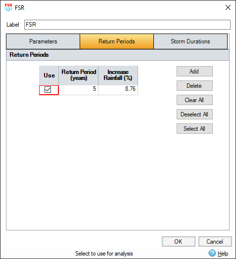

Return Periods
Return periods from 1 to 1000 years are provided.

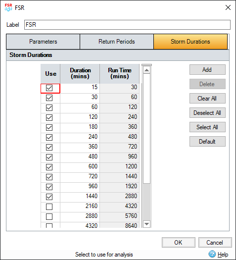

Storm Durations
A set of Storm Durations and run times must be specified for the analysis to run back to back.
