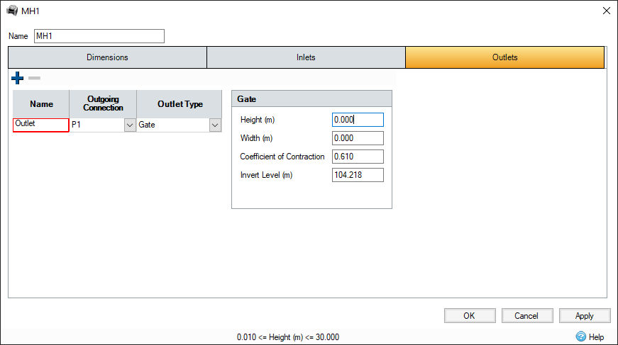

Gate
Gate Outlet allows a gate control to be modelled. The gate outlet uses the Torricelli's equation to calculate the flow when the gate is surcharged. When unsubmerged, the flow through the gate is calculated using the weir formula.
Specification
Height – Enter the size of the gate.
Width – Enter the size of the gate.
Coefficient of Contraction – Enter the coefficient of contraction of the gate. A default value of 0.61 is given and is suitable for a vertical gate
Invert Level – Enter the invert level of the gate.
