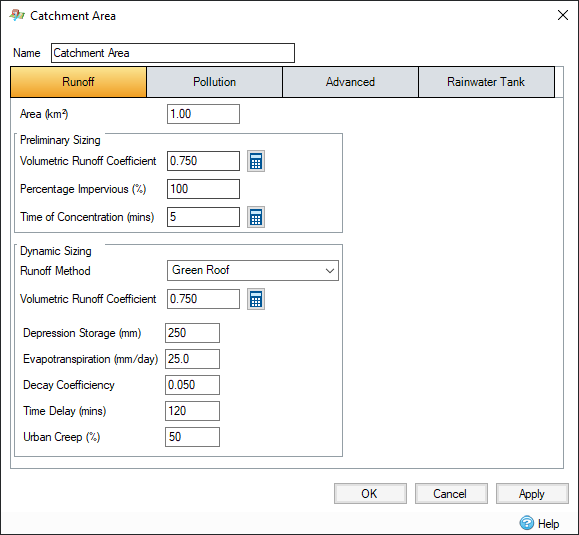

Depression storage – The depth of water falling on the Green Roof that is permanently held within it. Research in the UK has shown the average depression storage value to be 5% of the soil substrate depth.
Evapotranspiration – This is the amount of water that is lost to the environment due to evaporation and transpiration. The software uses the value during continuous analysis as the rate that the available depression storage is recharged. The evapotranspiration rate alters with location and climate conditions.  Typical values for the UK, if no better data is available, are as follows:

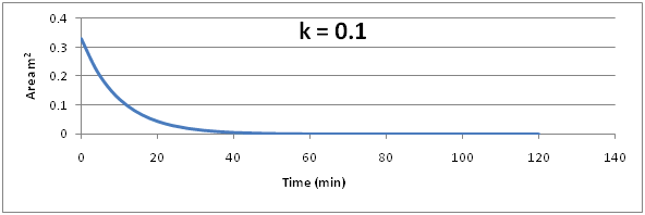

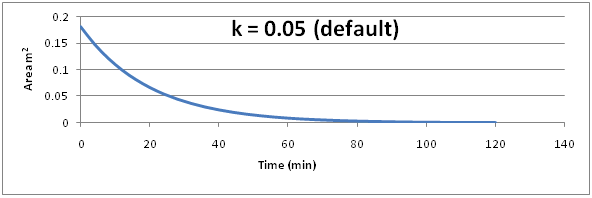

Decay coefficiency [k] – The k value affects the decay of the areas calculated, so should be edited with caution. The two graphs below plot the areas calculated and show the difference made by editing the k value. The higher the value, the quicker the roof will drain down.
Time Delay – This is the time over which the decay occurs, typically 120 minutes, and therefore the areas are spread out. Adjusting this value will not affect the decay of the curve, as explained in the equations below. However, it will truncate or extend the curve accordingly. At no stage is area lost, it simply affects the amount of time that it is allowed to decay for.
Urban Creep – This scales the impermeable area by the amount specified. This can be used to take the increase of urban areas, or other factors, into account. This value is only enabled (and used) when the analysis creep of the Analysis Criteria is set to 'Use Catchment Areas'.
