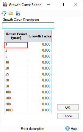

Growth Curve Editor
The Growth Curve Editor allows you to enter Growth Curve Factors for the ICP SUDS, IH 124 and ADAS 345 methods.
Note: This option may not be available for your region. For more information, refer to the Regionalisation topic.
New – This button allows you to clear the spreadsheet date and start a new growth curve.
Open – This button allows you to load a GCF, IDGCFX, GCFX or SRCX (MicroDrainage, Source Control module) file.
Save – This button allows you to save to a IDGCFX file.
Growth Curve Description – This field allows you to enter a description of the growth curve.
Spreadsheet – Enter the Growth Curve Factors for each return period. A .GCFX or .GCF file can be loaded into the form.
