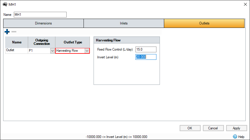

Harvest Flow
Harvesting Flow Outlet is a type of a Fixed Flow control – the constant flow rate occurs when the water level exceeds the invert level.
Specifications
Invert Level – Enter level when flow will commence.
Fixed Flow Rate – Enter the required constant flow rate.
