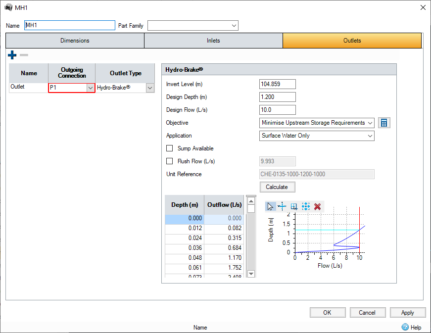

Invert Level  – The invert level of the control.

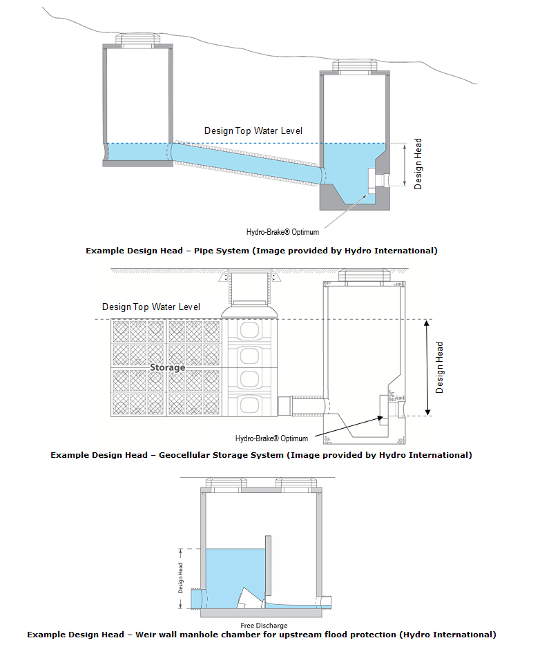

Design Depth – The desired design depth of the control (where the vortex is fully initiated). This should be entered as a depth above the invert level of the control, and will vary between different structures and manholes depending on the depth of storage structure and desired freeboard.
Design Flow – The desired design flow of the control (where the vortex is fully initiated).
Objective – The Hydro-Brake® design objective, see below for further details.
Application – The Hydro-Brake® design application, see Hydraulic Characteristics below for further details.
Sump Available – Indicates whether or not there is the provision of a sump to accommodate the flow control.
Flush Flow – See Hydraulic Characteristics below for further details. If the tick box is unticked, this defaults to the Design Flow.
Unit Reference – This Unit Reference indicates the model of Hydro-Brake®.

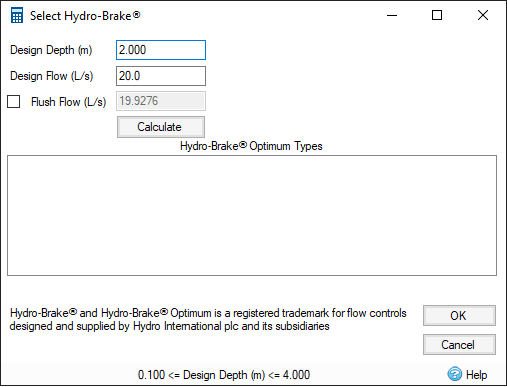

To see a list of possible units, a Calculator is provided:
Design Depth, Design Flow and Flush Flow can be specified as before. Retrieving results via the Calculate button will return the Unit Reference and Outlet Diameter for each Objective.

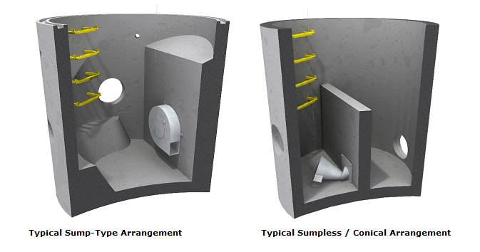

Sump-type
Surface/storm water only
BBA and WRc Approved.
Design objective can be specified (see Section 4.1 below)
Sump-type units require the provision of a sump to accommodate the flow control. Sump-type units are unsuitable for use in foul/combined systems.
Non-sump-type
Foul/combined and surface/storm water
Non-sump-type units do not require the provision of a sump to accommodate the flow control. Instead the unit is benched into the chamber. Non-sump-type units are suitable for use in both foul/combined systems and surface/stormwater systems.
