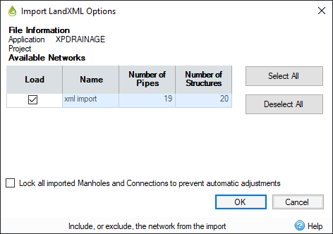

Imports Options
This option allows you to import LandXML file into InfoDrainage. When importing a LandXML file, the contents of the file are shown to allow the selected file to be validated and the required networks to be selected.
Application
Displays the name of the application that saved the file, with the version in brackets after the name.
Project
Displays the name of the project the file was created for. This may be blank but will default to the file name in most applications, i.e. the DWG file used to create the LandXML file in Civil 3D.
Available Networks
Displays information on the set of networks within the file to indicate what information will be loaded. You can then turn a network on or off using the tick box in the Load column.
If the Lock all imported Manholes and Connections to prevent automatic adjustments option is ticked, the import will set each manhole and connection to have their levels locked using the Lock state.
