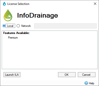

Local
Selecting local will limit the available licences to those available locally to the machine only.
This option is disabled if there are no locally available licences.
Features Available – A list of all features available to licences local to the machine. The highest tier available is selected when OK is clicked with Local selected.
Launch ILA – Clicking this button opens the Innovyze Licence Administrator.

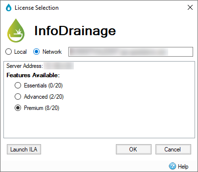

Network
Selecting network allows for search and selection of network licences.
Network – This text box can be used to manually enter a server name or address. This server will be searched for InfoDrainage licences. If the server with the given name or address cannot be found, or the server does not have any InfoDrainage licences, an error icon will be displayed here.
Server Address – The address of the server being searched. This will always show the address, even if the server name was given.
Features Available – A list of all InfoDrainage features. The numbers in brackets represent the number of seats in use, followed by the total seats. If no seats are available for a feature, it is disabled. A feature must be selected for use to apply the licence.
