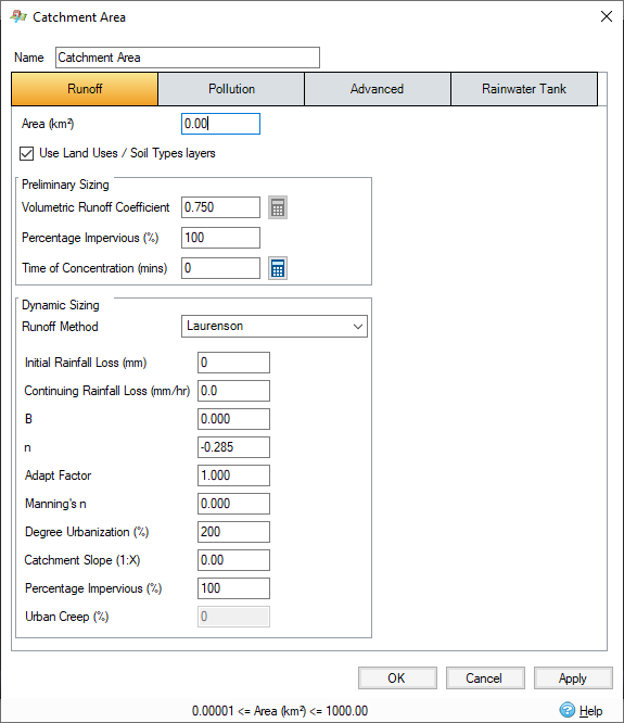

Initial Rainfall Loss – Specifies the depth of rainfall that infiltrates before any runoff occurs.
Continuous Rainfall Loss – Specifies the loss that occurs after the initial loss has been satisfied.
B - This can be entered or calculated from the equation in section "Coefficients B and n" below.
n – Storage non-linearity exponent by default is set to -0.285
Adapt Factor – Can be used as a multiplication factor used during calibration to modify the calculated B. It will default to value of 1.
Manning's n – PERN is an adaption factor used to introduce the effect of pervious catchment roughness as follows:
n
PERN
0.010
0.4
0.015
0.5
0.025
1.0
0.100
3.0
Degree Urbanisation – Fraction of catchment urbanised.
Catchment Slope – Modified equal area slope (%).
Percent Impervious – Impervious portion of the Inflow area.
Urban Creep – This scales the impermeable area by the amount specified. This can be used to take the increase of urban areas, or other factors, into account. This value is only enabled (and used) when the analysis creep of the Analysis Criteria is set to "Use Catchment Areas".
