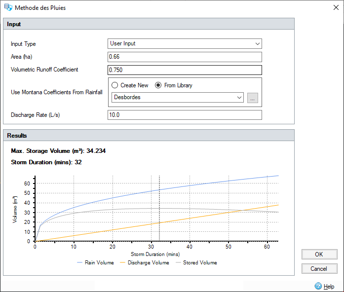

The Methode des Pluies calculator is divided into an Input and a Results section.
The Input section has the following parameters:
- Input Type: Select either User Input to type in a specific area or Use Plan Data, which will use the sum of the contributing area from all the Inflow nodes on the Plan.
- Area: This is specified by the user. If Input Type: User Input is chosen, otherwise if Input Type: Use Plan Data is chosen, the value is set to the sum of the contributing area from all the Inflow nodes on the Plan (and made read-only)
- Volumetric Runoff Coefficient (Input Type: User Input only): Specify the volumetric runoff coefficient for the specified area.
- Use Montana coefficients from Rainfall: Select the Desbordes Rainfall from which the Montana coefficients are taken. Note that the Methode Des Pluies uses the selected Desbordes rainfall's Intense a and b coefficients to calculate the total rain depth over a given duration, and does not use the double-triangular rainfall profile. Note that the convention in InfoDrainage is to specify the Montana B coefficient as positive (some sources specify it as negative).
- Discharge Rate: constant discharge rate leaving the Stormwater Control.
Note: The results section is updated as input values are changed, as long as the input values are legal; if any input values are illegal then results are not displayed with the illegal values highlighted by a red triangle and associated warning.
The Results section consists of:
- Two fields which give maximum storage volume and the corresponding storm duration.
- A graph of rain volume, discharge volume and stored volume vs duration.
