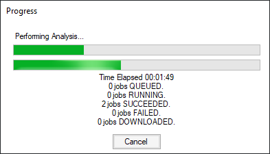

Simulation Progress Form
The simulation progress form is displayed upon a request to perform 1D or 2D analysis with cloud analysis available. See File Preferences to enable this option.
Below is an explanation of the feedback messages provided by this form.
Configuring Analysis – Pre analysis configuration is being performed.
Requesting Analysis – Attempting to establish a connection to the web service.
Performing Analysis – Connection to the web service has been established. The service is now being polled for status updates.
Time Elapsed – A timer used to display the time taken by the analysis process.
n jobs QUEUED – The number of processing jobs awaiting execution in the web service.
n jobs RUNNING – The number of processing tasks currently executing within the web service.
n jobs SUCCEEDED – The number of tasks which have completed successfully.
n jobs FAILED – The number of tasks which failed to complete successfully.
n jobs DOWNLOADED – The number of completed tasks’ results successfully downloaded from the web service.
Processing Results – The results from the analysis have been obtained, the data is being processed for display in InfoDrainage™.

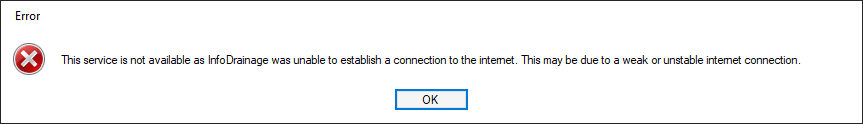

Error Messages
If an error occurs at any point during the cloud analysis process an appropriate error will be displayed.
For example, if internet connection is interrupted whilst attempting analysis the following message will be displayed:
