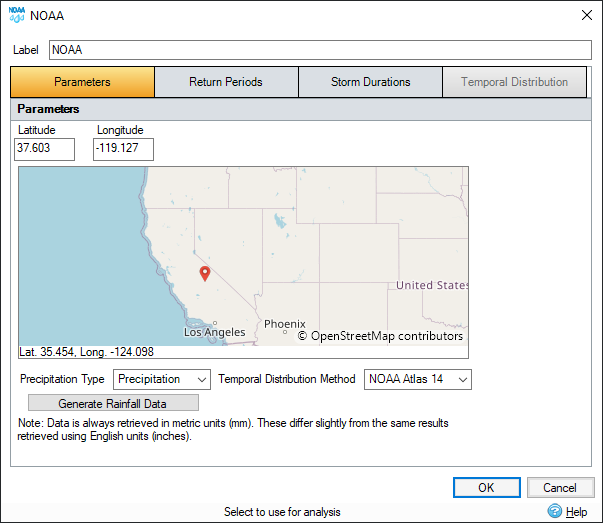

Parameters
Latitude, Longitude
Location's position as decimal values. This can be manually entered or selected by clicking on the map.
Precipitation Type
Select the precipitation type of the rainfall data retrieved from the NOAA website. The options are precipitation or rainfall depth.
Note: Time Series Type: For design, the use of Partial Duration is assumed.
Temporal Distribution Method
Select the temporal distribution method to use. For the NOAA Atlas 14 method, the temporal distribution data will be retrieved from the NOAA website. For the NRCS method, a series of static tables will be used to generate the temporal distribution data. Please refer to the following links for more information on NRCS temporal distribution data:
Generate Rainfall Data
Click this button to retrieve the rainfall data from the NOAA website. Please note that there are some locations that are not within a project area. If this is the case, then a warning message will be shown.
InfoDrainage retrieves rainfall data from the NOAA website in metric units (millimetres). This differs slightly from the same rainfall data retrieved in imperial units (inches).

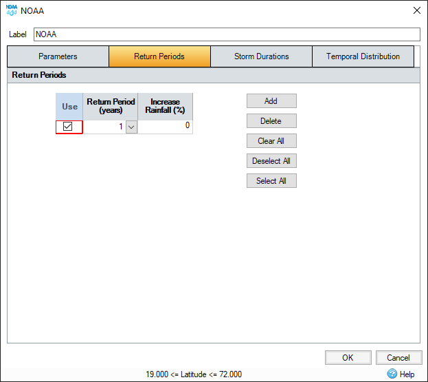

Return Period (years)
A selected set of return periods is available.

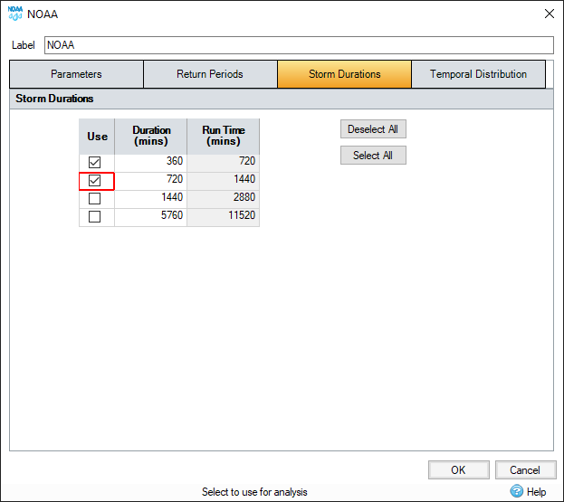

Storm Durations
A set of Storm Durations and run times must be specified for the analysis to run back to back. Please note that at least one storm duration must be selected in order to retrieve NOAA temporal distribution data.

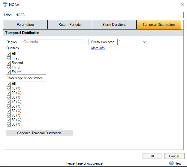

Region
Select the primary region for the rainfall. For NOAA temporal patterns, this value is retrieved from the NOAA website when generating rainfall data and is not editable.
Distribution Area/Type
Select the distribution area for NOAA temporal patterns or the distribution type for NRCS patterns.
Quartile
Select the quartile of the duration for NOAA temporal patterns.
Percentage of Occurrence
Select the percentage of occurrence for NOAA temporal patterns.
Generate Temporal Distribution
Retrieve the temporal distribution data from the NOAA website if using the NOAA Atlas 14 method.
