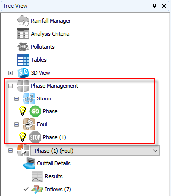

The Phase Management option appears in the Tree view below the Design level options and just before the Phase Selector. This provides a quick view on the available phases, together with an image to indicate if they are being analysed or not. Expanding the node will show you the list of available phases, which are grouped by phase type (either Storm phase and Foul phase).
Including in Analysis
A phase can be included in the analysis by clicking the or not  icons. To keep analysis times down, it is recommended that you turn off any phases or scenarios you are not currently interested in. They can be turned back on later.

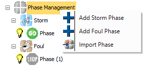

Creating a Phase
Right-clicking the Phase Management will display a menu that provides the Add Storm Phase or Add Foul Phase option. Selecting this option will create a new, empty phase and will select it on the Phase Selector ready for editing.

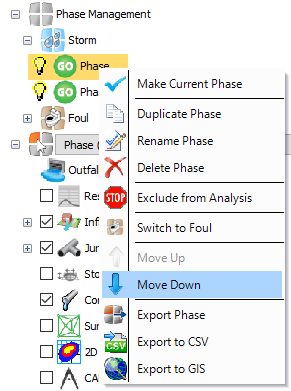

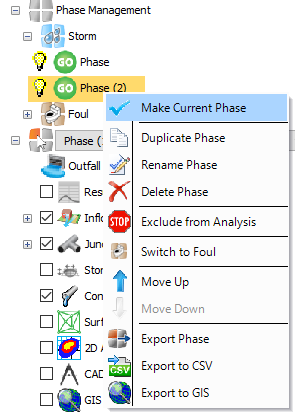

Right-clicking an individual phase shown under the Phase Management will display a menu that provides the following options:
Duplicating a Phase
Selecting this option will create a duplicate of the selected phase, and will select it on the Phase Selector ready for editing.
Deleting a Phase
Selecting this option will remove the phase from the design, and will update the current phase shown on the Phase Selector if needed. This option will be enabled if you have two or more phases. It is not possible to delete the only phase in a design.
Renaming a Phase
Selecting this option will enable you to rename the phase selected, which then allows a new name to be entered for the phase. Clicking the node, or pressing Enter, will confirm the name change.
Making a Phase current
Selecting this option will make the selected phase current in the same way as a selecting a phase on the Phase Selector.
Adjusting Phase order
It is possible to adjust the order of a phase within the phase list. Selecting Move Up will result in the phase being shown higher up the list, while Move Down will move the phase lower down the list.

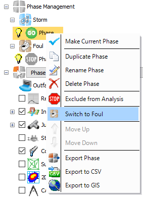

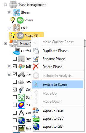

Switching Phase type
It is possible to switch the type of the phase. Right-clicking a Storm phase would display the option Switch to Foul.
Right-clicking a Foul phase would display the option Switch to Storm.

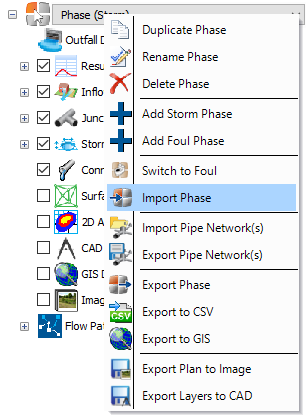

Importing a phase
To import a phase using the Tree view:
  1. Right-click the Phase in the Tree view and then select Import Phase.
  2. Locate the phase that you want to import and then click Open.

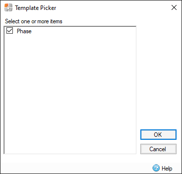

  3. In the Template Picker dialog, select the items accordingly.
  4. Click OK, and the phase will be imported in your model.
