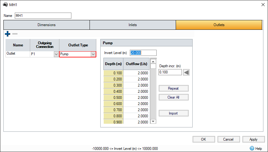

Pump
Pump Outlets allow a depth-flow relationship to be entered in order to represent the performance curve of a pump.
Specifications
Invert Level – The invert level of the control.
Spreadsheet – Enter the required flow rate for each depth of water.
Depth Increments – The depth increment can be set by entering the required increment into the Depth Incr. field and clicking the Apply button (arrowhead).
Alternatively, the depths and outflow rates can be entered freehand into the table.
Import – Data can be loaded from .TXT, .CSV or Excel file using the Import option, which utilises the Universal Importer.
