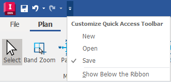

Quick Access Toolbar
The Quick Access Toolbar allows you to quickly access the following commands:
New – Creates a new InfoDrainage design.
Open – Loads an existing InfoDrainage design file.
Save – Allows the site to be saved to an IDDX file.
Undo – Allows the last input or action to be undone.
Redo – Allows the Undo of the last input or action to be re-performed.
Customise Quick Access Toolbar
This drop-down menu displays the option for New, Open and Save Quick Access, as well as allows control of show/hide ribbons and the location of the Quick Access Toolbar.
