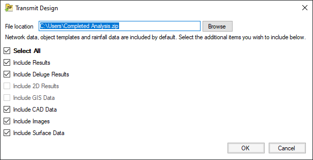

The Transmit Design feature provides users the option to package their designs, making it easier to share with clients and collaborators.
InfoDrainage saves the packaged design into the same folder as the open .iddx file by default. To save the package into a different folder, click Browse and navigate to the desired location. Using the same form, you can also choose to have the .iddx file saved to be compatible with previous versions of InfoDrainage by selecting the required year from the drop-down list.
While the packaged file automatically includes the network data, templates, and rainfall data, additional items such as Results, Deluge Results, 2D Results, GIS Data, CAD Data, Images and Surface Data can be included by simply clicking the appropriate tick boxes. Note that if the Include Images box is ticked, for each image its corresponding world file is also included, if it exists. If the design has ARR19 the files generated during the creation of the rainfall, will be included in the transmitted design.
