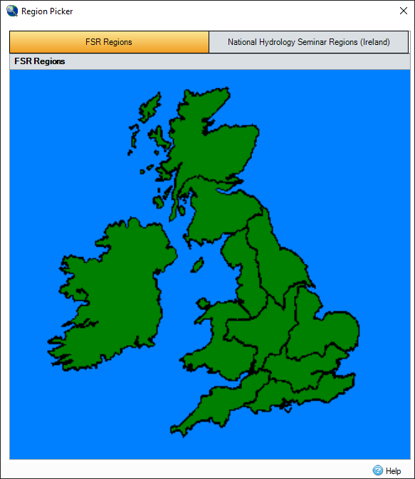

The UK and Ireland Region Picker allows you to select a specific region on the map, and the corresponding data will be automatically populated.
The map shows region numbers of the catchment based on FSR Figure I.2.4, which is used to calculate the different return periods as described below.

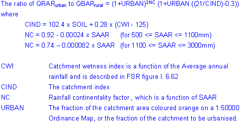

QBAR rural – Calculated using the following formula (equation yields m³/s):
QBAR urban, Adjustment for urbanisation – Calculated from IH report 124 equations 7.2 to 7.4. CIRIA Book 14, 3.2.2 (equations yield m³/s).
Urbanised catchment growth factors for return periods not exceeding 50 years

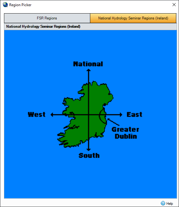

The map shows Region numbers of the catchment based on the National Hydrology Seminar, which are used to calculate the different return periods as described below.
The following growth curves are used for Ireland taken from the paper "Comment on Estimation of Greenfield Runoff Rates" – A.M.Crawley & C.Cunnane – National Hydrology Seminar 2003 (the one-year value is take from the Greater Dublin Strategic Drainage Study, Volume 2.)
