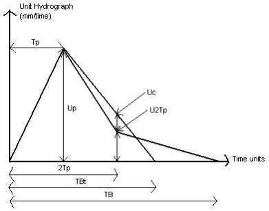

The Unit Hydrograph itself is triangular in shape for the FSR/FEH methods.  The length of the base, the height of the apex and the distance the apex is from the start are given by the outputs TB, QP and TPt respectively.
However, using the ReFH method the unit hydrograph is based on a kinked triangle. The length of the base, the height of the apex, the distance the apex is from the start and the kink point are given by the outputs TB, QP, Tp and Uc respectively.

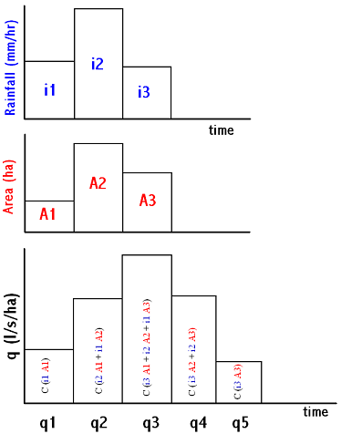

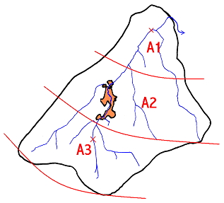

The following figures illustrate the similarities between Unit Hydrographs, Time-Area and the Rational Methods.  A Unit Hydrograph has units of “Area/Time” while a Time-Area table has units of “Area”.  Therefore, to convert the Unit Hydrograph ordinates to Flow it must be multiplied by a rainfall depth (p, cm).  The Time-Area ordinates are multiplied by a rainfall rate (i, mm/hr) to convert them to “Flow”.  The constant 2.78 converts (mm/hr * ha) to (l/s) in the rational and time-area methods – a more accurate conversion is (1.0/0.36).  Note also that the normal units used in the Unit Hydrograph method are m³/s for flow, km² for catchment area, cm for rain, hours for time and the conversion constant for this set of units is also 2.78.  Therefore either set of units may be used with the equations that follow.
It can be seen from these diagrams and calculations that a Time-Area table may be converted to a unit hydrograph by multiplying its ordinates by 2.78, so that the integration of the unit hydrograph is always 2.78*Area (for either set of units discussed above).

Convolution of Time/Area and Net Rainfall
q1= 2.78 * (i1 A1)
q2 = 2.78 * (i2 A1 + i1 A2)
q3 = 2.78 * (i3 A1 + i2 A2 + i1 A3)
q4 = 2.78 * (i4 A1 + i3 A2 + i2 A3 + i1 A4)
q5 = 2.78 * (i5 A1 + i4A2 + i3 A3 + i2 A4 + i1 A5)
Where i1, i2, i3 etc. are the net rainfall rate (mm/hr) in time intervals 1, 2, 3 etc. and A1, A2 etc. are the values obtained from the Time/Area graph for the same intervals.

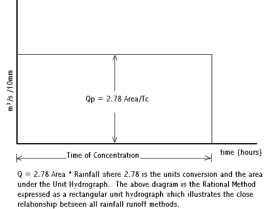

The Rational Method expressed as a rectangular unit hydrograph
Example
If Tc = 3 hours and the calculation interval dT = 1 hour then:
q1= p1 * 2.78 A/3
q2 = p1 * 2.78 A/3 + p2 * 2.78 A/3
q3 = p1 * 2.78 A/3 * p2 * 2.78 A/3 + p3 * 2.78 A/3
q4 = p2 * 2.78 A/3 + p3 * 2.78 A/3
q5 = p3 * 2.78 A/3
For the Rational Method, the rainfall is assumed to be constant over Tc, and the rainfall rate per hour is the same as the rainfall depth for a 1-hour dT therefore:
 i = p1 = p2 = p3
Max flow q3 = 2.78 i A     .. the Rational Formula   QED
The equivalence is true for any Tc and dT.
