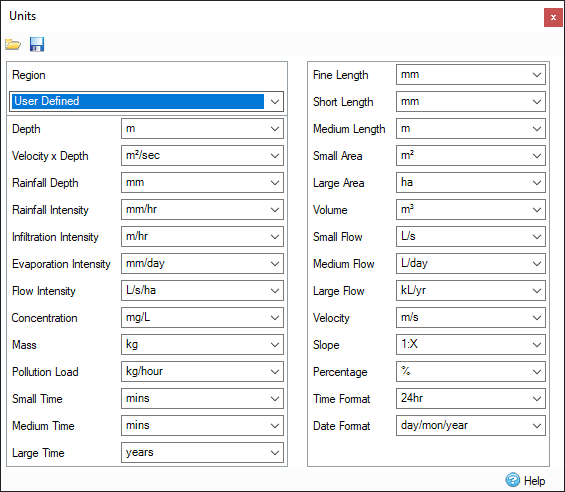

  1. In InfoDrainage, open the File > Preferences menu option.
  2. Click the Edit button to open the Units dialog.
  3. Modify the units for specific measurements.
  4. After the units have been set, save the file with the name pattern described in the previous paragraph.

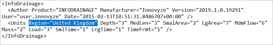

To edit the .idux file:
  1. Navigate to the InfoDrainage installation directory (usually in C:\Program Files\Innovyze\InfoDrainage), or to the location where the *.idux file is saved.
  2. Open the *.idux file in a text editor.
  3. Enter the appropriate region after the "Units" tag.
  4. Save the file.

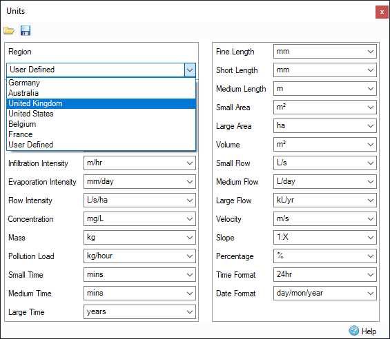

  5. Run InfoDrainage. The name of the region will then appear in the Region combo box in the ‘Units’ form as a selection choice.
