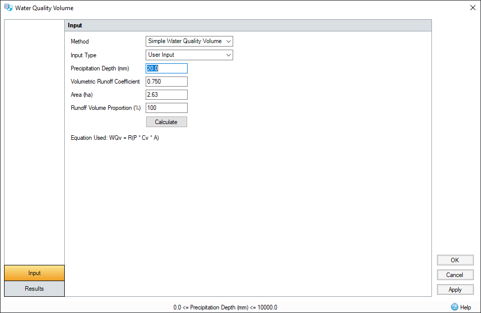

Simple Water Quality Volume
 WQv = R(P*Cv*A)
WQv = Water Quality Volume/Treatable VolumeP = Precipitation DepthCv = Runoff CoefficientA = AreaR = Proportion of runoff volume required (defaults to 100%)

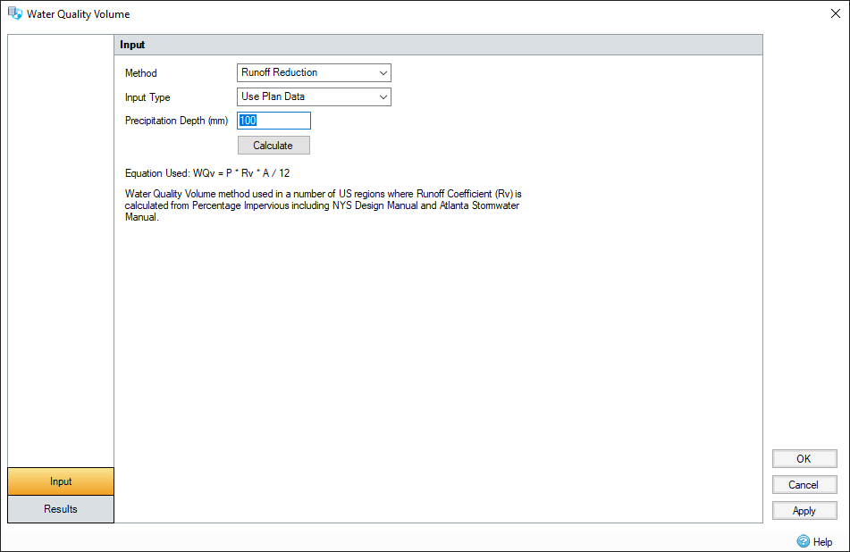

Runoff Reduction
WQv = P * Rv * A / 12
WQv = Water Quality Volume/Treatable Volume (acre-ft)P = The 90th percentile storm (inches) Rv = 0.05 + 0.009 * I
I = Percent impervious cover
A = Area (acres)
Water Quality Volume method used in a number of US regions where Runoff Coefficient (Rv) is calculated from Percentage Impervious including NYS Design Manual and Atlanta Stormwater Manual.

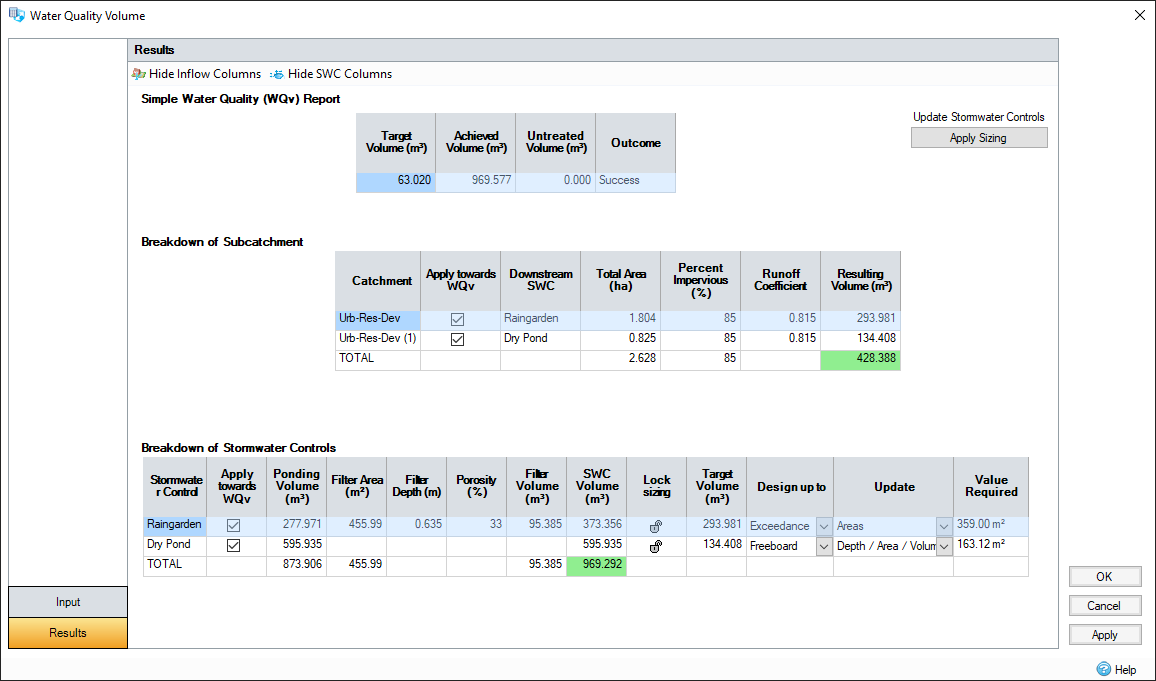

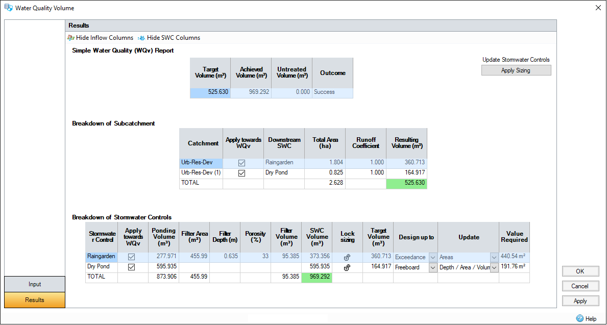

Results
When all variables have been set as required, click 'Calculate' to generate the result. If inputs are wrong, either a warning will appear on the form or the Validate form  will pop up to indicate the error(s) from the plan data.
The results tab will show the summary table together with a breakdown of the Inflows and Stormwater Controls as required.
Toolbar – The toolbar provides two options that allow the additional columns in the Inflows and SWCs tables to be hidden.
Summary Table – This shows a breakdown of the results of the calculation when compared with the current phase or stormwater control. The columns are:
Target Volume – The resulting volume that has been determined from the calculation.
Achieved Volume – The volume available within the Stormwater Control(s) in the current phase.
Untreated Volume – The amount of volume that is currently untreated, i.e. Target Volume – Achieved Volume.
Status – Shows the outcome, which will be 'Success' if the Achieved Volume is greater than or equal to the Target Volume, or 'Failure' otherwise.
Inflows Table - This shows a breakdown of the sub-catchments within the current phase together with the volume they contribute to the Target Volume based on the selected method. This table is only shown if the 'Use Plan Data' Input type is selected.  If the calculator is accessed via the SWC Sizing Calculator, the contents of the inflows will be limited to just those that directly connect to the SWC or enter it via upstream junctions but do not pass through another SWC. The columns are:
Catchment – The name of the Inflow.
Apply Towards WQv – Allows the Inflow to be included, or excluded, from the calculations. This will remove it from the Target Volume total in the Summary table.
Downstream SWC (Global mode only) – The stormwater control that the given inflow is draining to.
Total Area – The total area provided by the catchment.
Percentage Impervious – The percentage impervious for the catchment, as specified on the Land Use tab (only shown for Runoff Reduction).
Runoff Coefficient – The value shown depends on the Method being used:
Resulting Volume – The total volume that the individual catchment contributes to the calculation.
Stormwater Controls Table – This shows a breakdown of the individual Stormwater Controls complete with the volume capacity they contribute to the Achieved Volume. This table is only shown if the current phase has Stormwater Controls. If the calculator is accessed via the SWC Sizing Calculator, the table shows only the Stormwater Control being sized. The columns are:
Stormwater Control – The name of the Stormwater Control
Apply Towards WQv (Global mode only) – Allows the SWC to be included, or excluded, from the calculations. This will remove it from the Achieved Volume total in the Summary table.
Ponding Volume – The volume available in the ponding aspect of the SWC. This includes: Bioretention (Ponding Area), Swale (Swale), Ponds, Tanks and User-Defined SWCs.
Filter Area – The plan area of the filter aspect of an SWC. This includes: Bioretention (Filter), Swale (Trench), Porous Paving, Infiltration Trenches and Soakaways.
Filter Depth – The depth of the filter aspect of an SWC.
Porosity – The porosity of the filter aspect of an SWC.
Filter Volume – The volume available in the filter aspect of the SWC.
Resulting Volume – The total volume available in the SWC, i.e. Ponding Volume + Filter Volume.
Lock Sizing (Global mode only) – Allows the SWC to be included, or excluded, from the calculations. This will remove it from the Achieved Volume total in the Summary table.
Target Volume (Global mode only) – The Water Quality Volume that has been determined by the calculation of the Plan Area being drained by the SWC. This is the volume that will be used to size the SWC.
Design Up To (Global mode only) – Choose the level that the volume will be provided up to when performing a Sizing:
Update (Global mode only) – Choose a parameter that is to be updated when the SWC is resized to the target volume. This list is specific to the type of SWC, and most of the options are self-explanatory, e.g. Length, Width, Base level, etc. Two options perhaps need a little more explanation:
Update Required (Global mode only) – The change to the dimension, selected in Update, that is required to meet the target volume. This will only be applied when the 'Apply' button is pressed.
Note: If a structure cannot be sized based on the currently selected settings, 'Unable to size' will be shown. If this is the case, please consider another update dimension and/or design up to setting.
