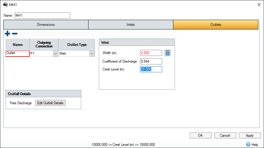

Weir Outlet allows a rectangular weir control to be modelled.

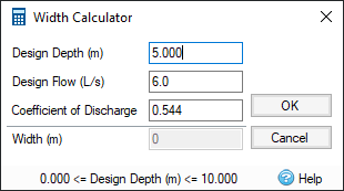

Width – Enter the width of the weir. If you are working to a maximum allowable discharge, then a Calculator is provided to help size the control. This gives two additional parameters:
Coefficient of Discharge – The discharge coefficient depends on the type of weir or flume chosen. A default value of .544 is given and is generally suitable for flow over a flood bank, round nose horizontal – crested weirs and rectangular flumes. Other values may be used, and as with the other controls, values for discharge coefficients may be found in any good reference on hydraulic control structures.

Crest Level – The crest level of the weir.
