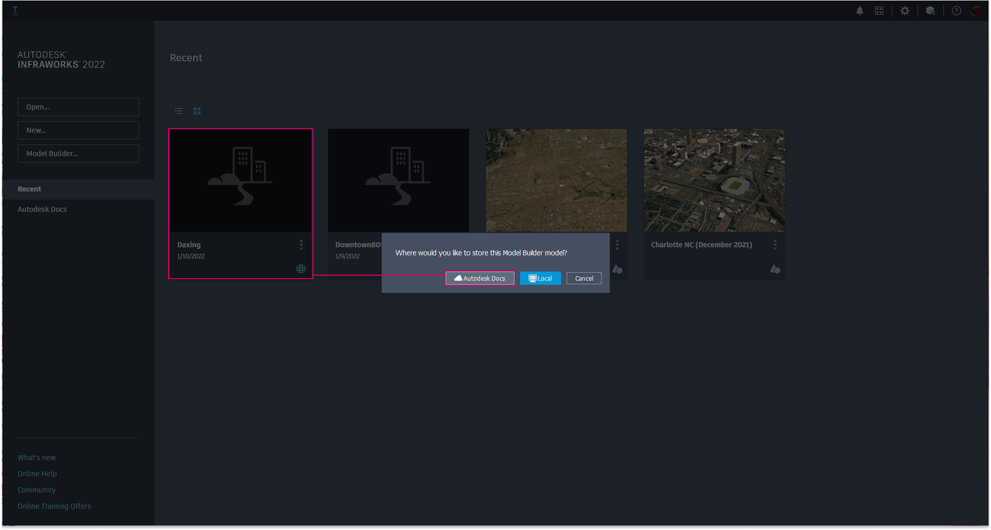

  1. On the InfraWorks Home Recent tab, click a model created by model builder.
  2. Click the Autodesk Docs button in the dialogue.
    model builder

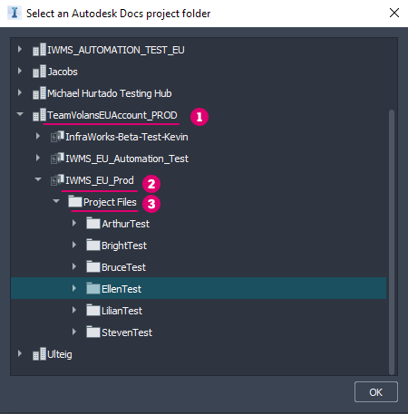

  3. Select European Account (1) glyph Project (2) glyph Project Folder (3), then click OK.
    select project folder

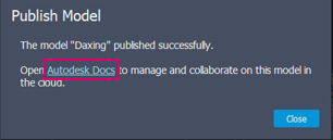

  4. Wait until the process completes successfully. You can open the model in Autodesk Docs either from the dialogue or toolbar button.

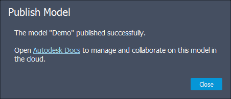

Publish local models to the project on the Europe data centre

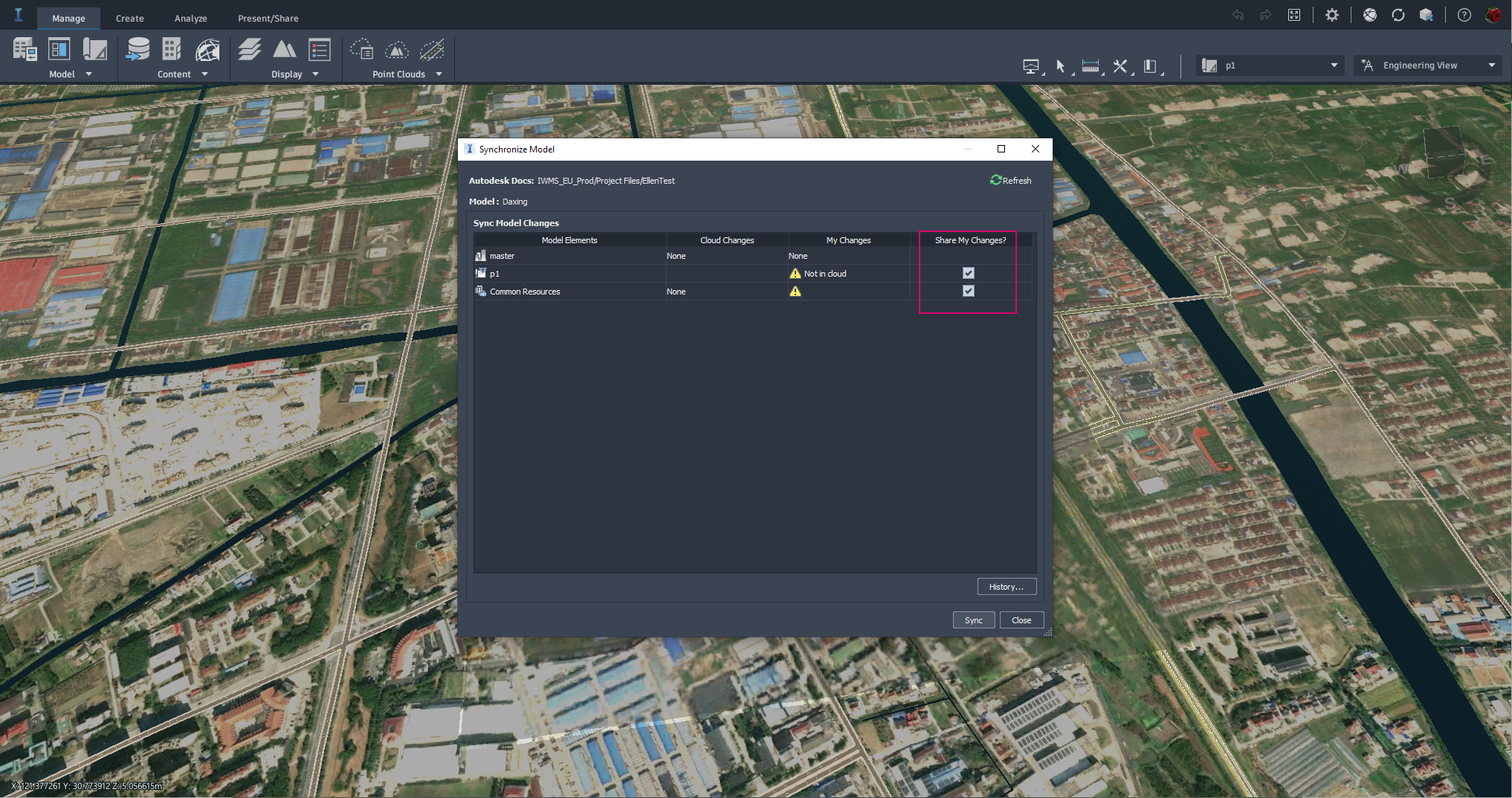

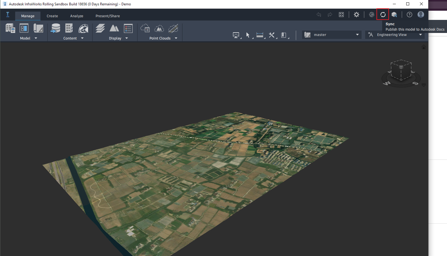

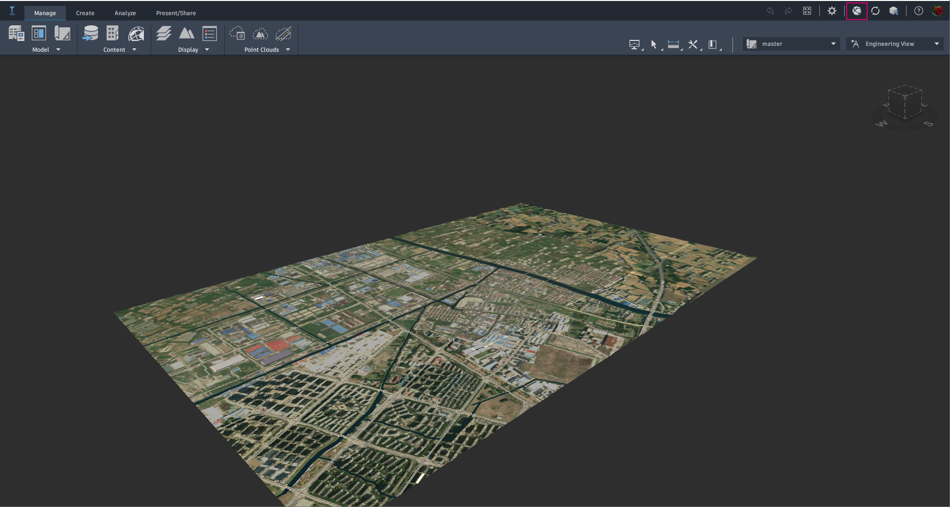

  1. Open the local model, click the top right Sync button.
    sync button

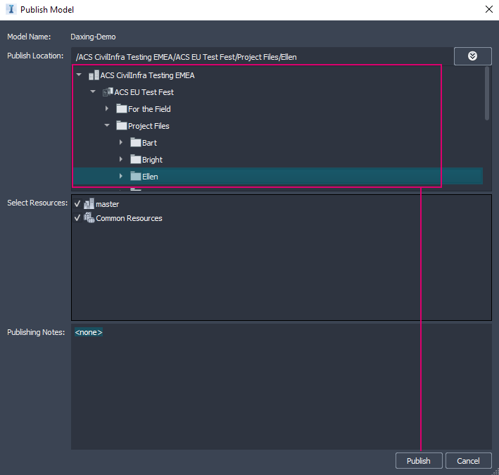

  2. Select European Account glyph Project glyph Project Folder, check resources to publish, then click Publish.
    select project
  3. Wait until the process completes successfully. You can continue to work with the model in InfraWorks or view it in Autodesk Docs.
    publish

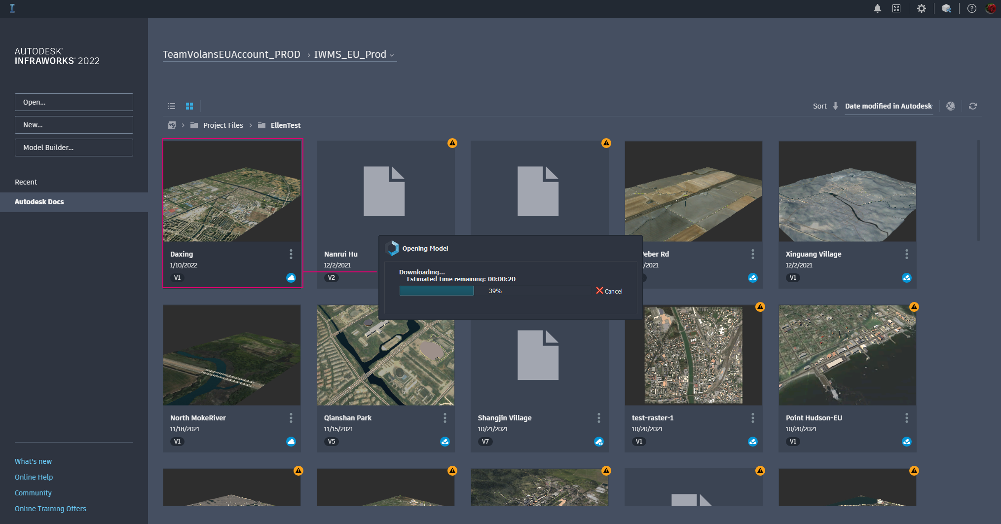

Download models from the project on the Europe data centre

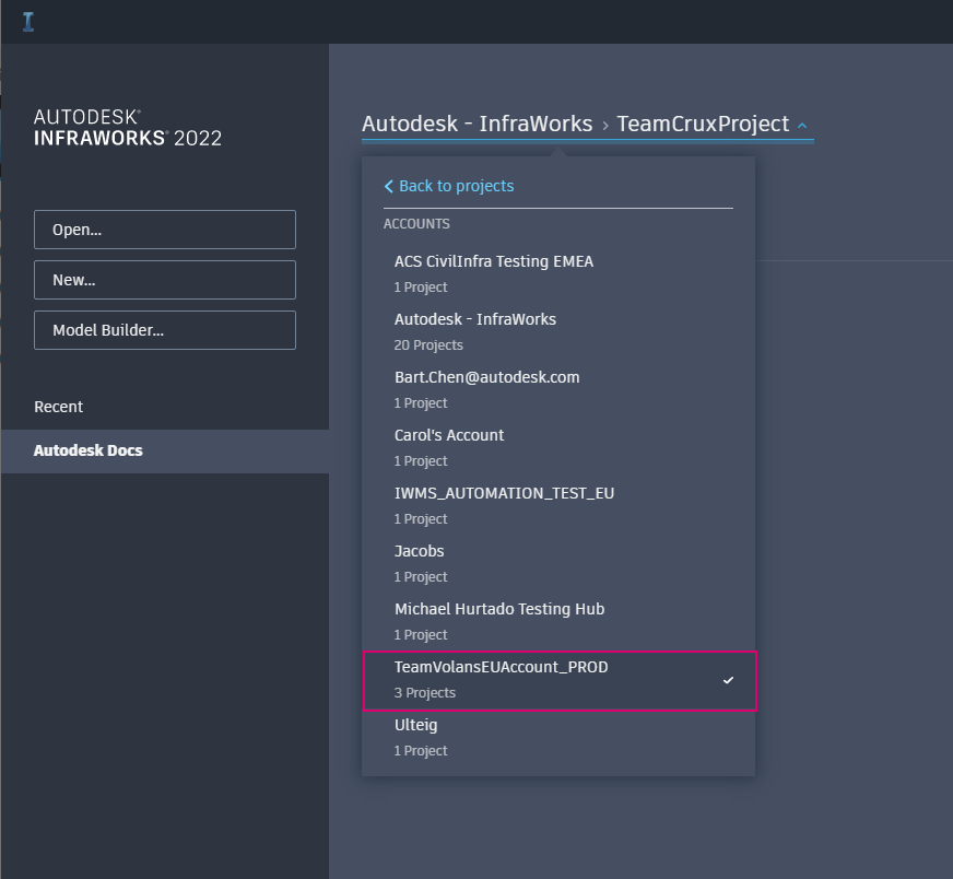

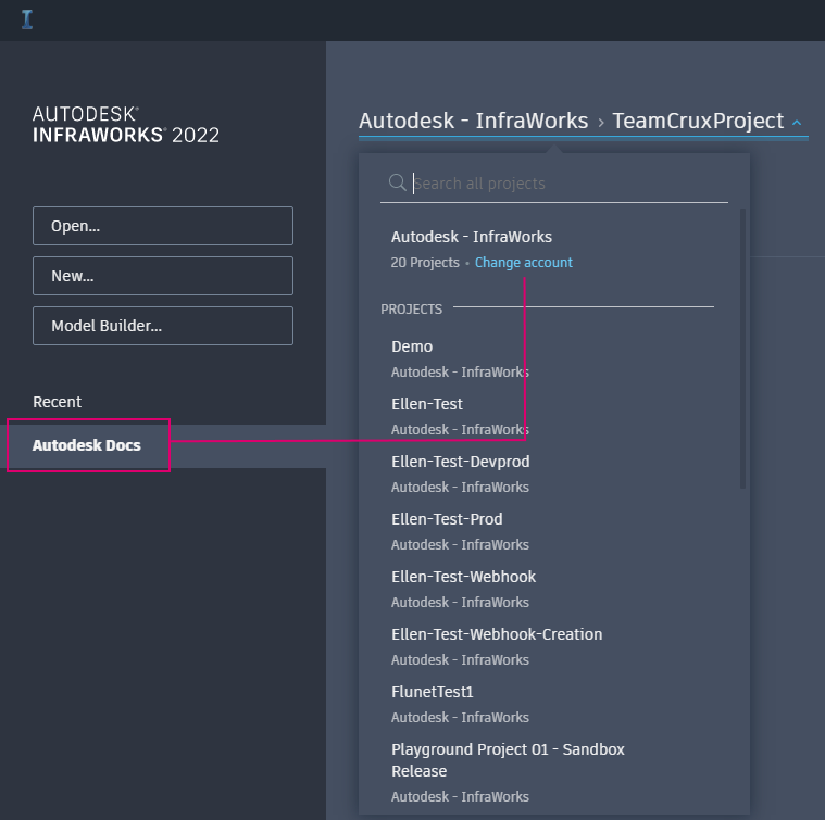

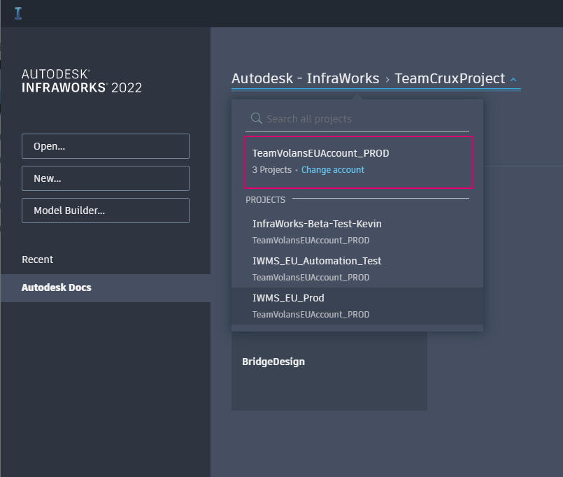

  1. Go to the InfraWorks home glyph Autodesk Docs tab, change to the acount on the Europe data centre if necessary and select a project to work on.
    switch
    select account
    select project
  2. Go to the project folder where model stored, all models will be displayed after a while.
  3. Click the model you want to download. The model is opened automatically when downloading completes.
    download

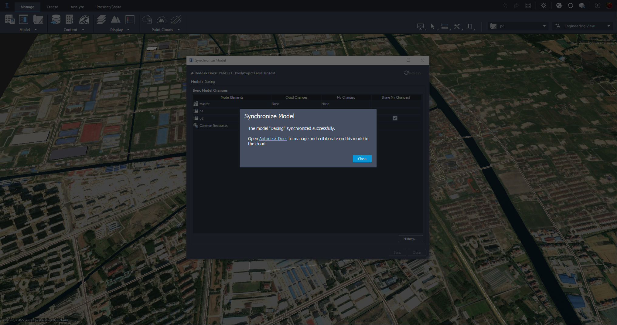

  4. Make some changes in the model, share it to others by model Sync.
    sync
    sync complete

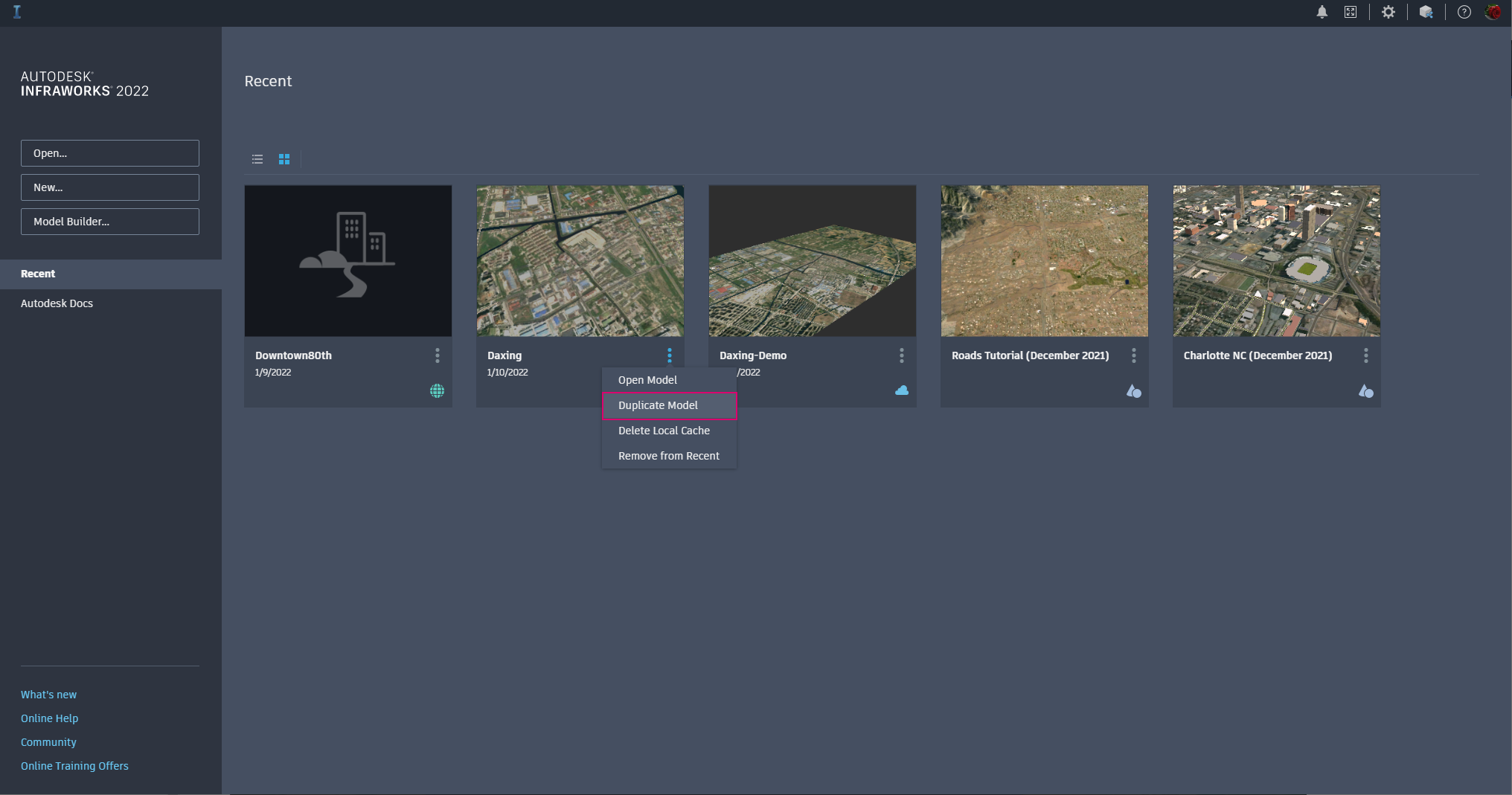

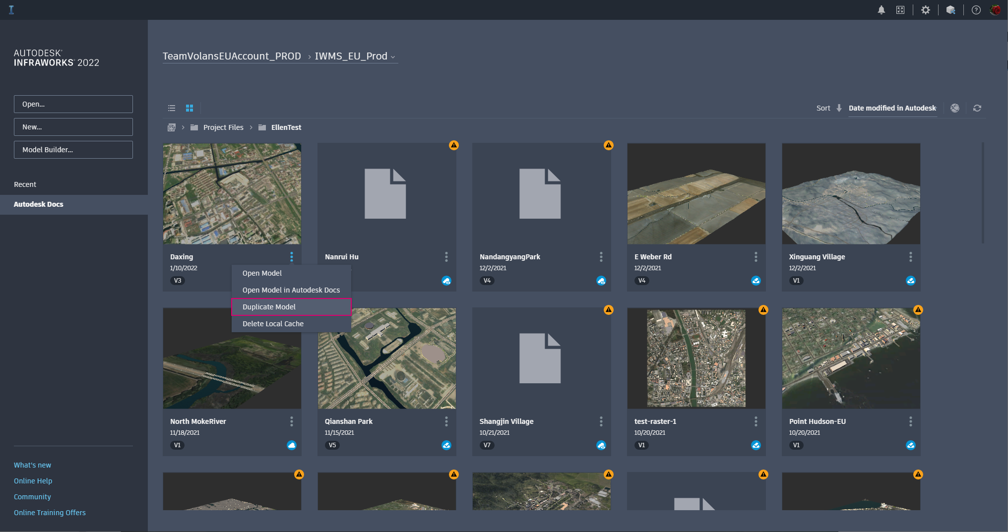

  2. Duplicate the model, which you can do in two ways.
    • Duplicate from InfraWorks home on either Recent or Autodesk Docs tab.
      Note: The duplicated model will not be opened automatically, you need to open it from the selected location manually.
      home duplicate
      home duplicate docs

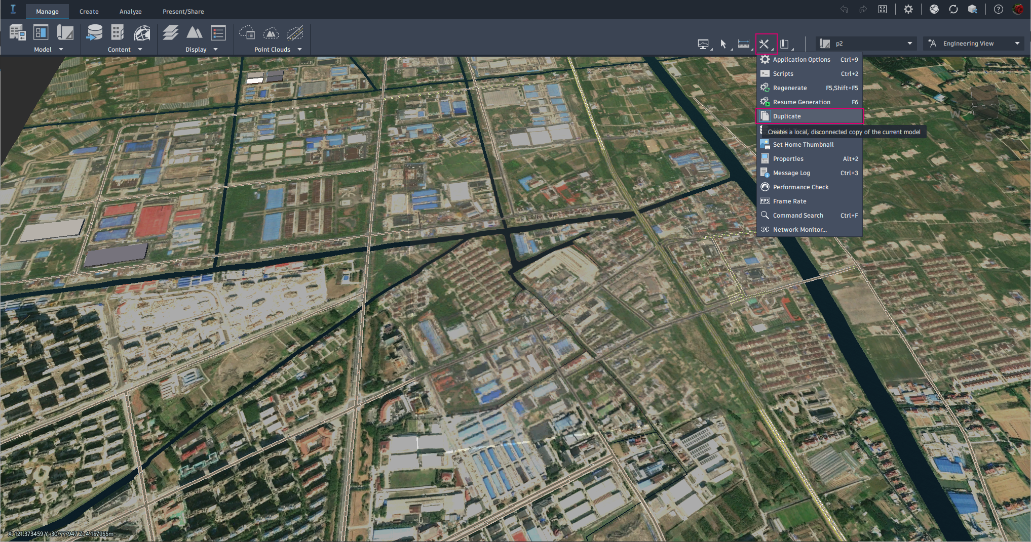

    • Duplicate the model from the dropdown menu while the model is open.
      duplicate
  3. Open the duplicated local model, then follow the same process above to publish the model to a project on the Europe data centre.
