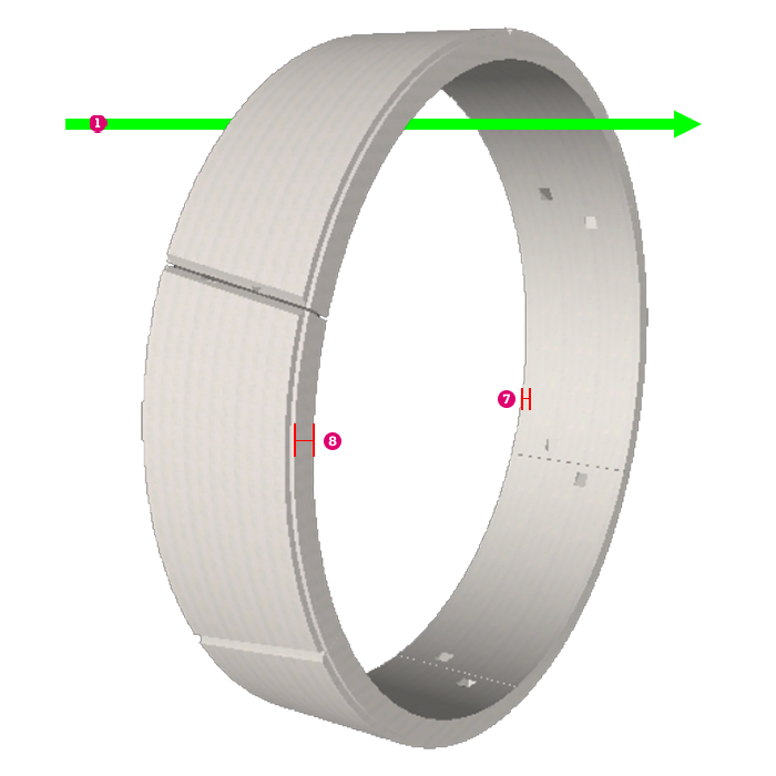

one Direction of Alignment five Taper1
two TunnelDiameter1 six Taper2
three TunnelDiameter2 seven WallThickness1
four SegmentLength eight WallThickness2

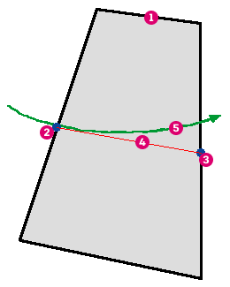

Bored Ring tunnel regions consist of a series of sequentially placed rings. The SegmentLength parameter determines the spacing of these ring segments which are placed with their centres aligned as closely as possible with the road alignment.
The first ring is positioned at the tunnel region start, and aligns with the tangent of the alignment at the region start.
one Ring Segment four Tangent
two Ring Back Centre five Alignment
three Ring Front Centre
Subsequent rings are placed so the start (back) face of each ring is flush with the end (front) face of the preceding ring.
Note: SegmentLength, Taper1, and Taper2 must be defined accurately for this to actually happen.

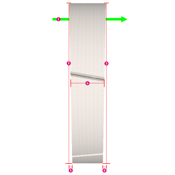

The angle of rotation for the next segment aligns the ring most closely with the alignment without introducing swerving. Swerving happens if the segments stray from the alignment due to a very tight curve and the ends of subsequent rings converge too quickly to the alignment and end up crossing to its other side.
one Alignment
two Ring Tangents (back to front)
three Ring Segment
This is remedied by checking each possible position of each ring to determine the minimum turning radius of the subsequent rings. If this minimum turning circle intersects the alignment then swerving can happen. The position chosen for the ring is the one where the end of the ring is closest to the alignment without introducing swerving. If all positions cause swerving then the closest position is chosen.
