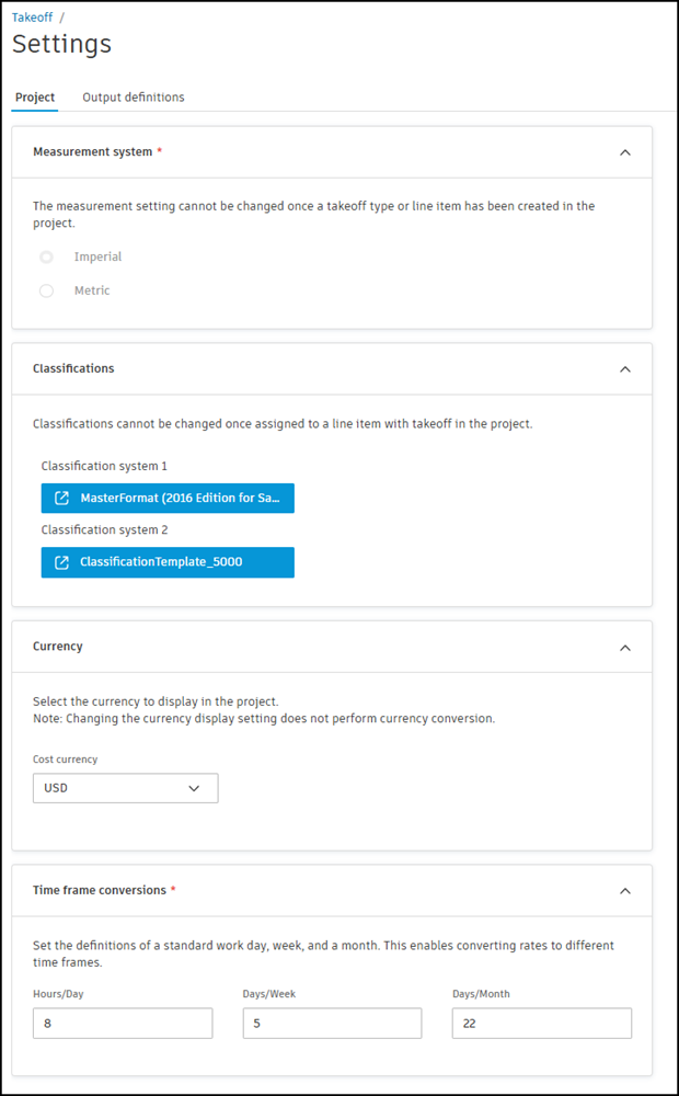

Under Project, you’ll find settings for Measurement, Classification systems and Currency for your Preconstruction project.

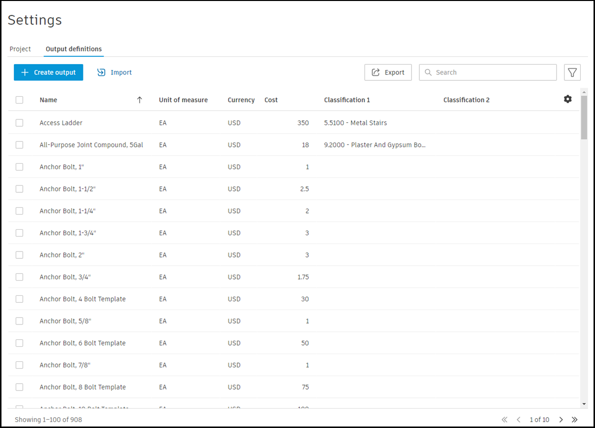

In the Output definitions tab, you can create, import and view the takeoff output definitions available for your takeoff work.

Settings in Takeoff has classification, measurement and currency settings that can be configured for your Preconstruction project. These settings can be found under the Project tab in Settings in the Takeoff tool.
Note: Currency and classification systems must be configured to appear in Takeoff.
Important:
IMPORTANT: Measurement and classification settings for a Takeoff project can’t be changed once a takeoff type or output definition has been created for the project. Classifications can’t be changed once the classification is assigned to takeoff in the project.
To set up a project for takeoff:
  1. Navigate to Takeoff in the left navigation in Preconstruction.
  2. Click Settings at the upper right of the page. The Project tab is open by default.
  3. Configure the following settings for your project:
    • Measurement system (required) – You must select a measurement system for a project before performing takeoff or creating an estimate. Choose between imperial or metric systems.
    Important:
    Measurement system settings for a Takeoff project can’t be changed once a takeoff type or output definition has been created for the project.
    • Classification systems (optional) – You may upload one or two classification systems to use under ‘Classification system 1’ and ‘Classification system 2’. The classification system and its codes are used to describe and organise takeoff and estimate line items. You may be familiar with common systems like MasterFormat® and UniFormat®.
      Important:
      Important: Classifications can’t be changed once a classification is assigned to an output with Takeoff.
    • Currency (optional) – Use the Cost currency drop-down to select the currency to display when viewing project costs.
    Note: Changing the currency display setting does not perform currency conversion.
    • Time Frame Conversions (required) – Set the definitions of a standard work day, week and month to enable converting rates to different time frames.

Create and import output definitions in Settings
In the Output definitions tab under Settings in the Takeoff tool, you can create, edit and view output definitions. You can also import multiple output definitions directly from a spreadsheet or from another project.
Use output definitions created in or imported to the Output definitions tab when creating takeoff types in the Takeoff viewer. Likewise, outputs for takeoff types created in the Takeoff Type panel can be saved to Output definitions.
Learn more about working with output definitions in Settings in Takeoff Output Definitions.
