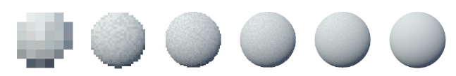

Preview (AA)
The initial AA samples used for the first progressive render. Negative values sub-sample the render, allowing faster feedback in the render window.
Initial Sampling Level from -6 to 0
