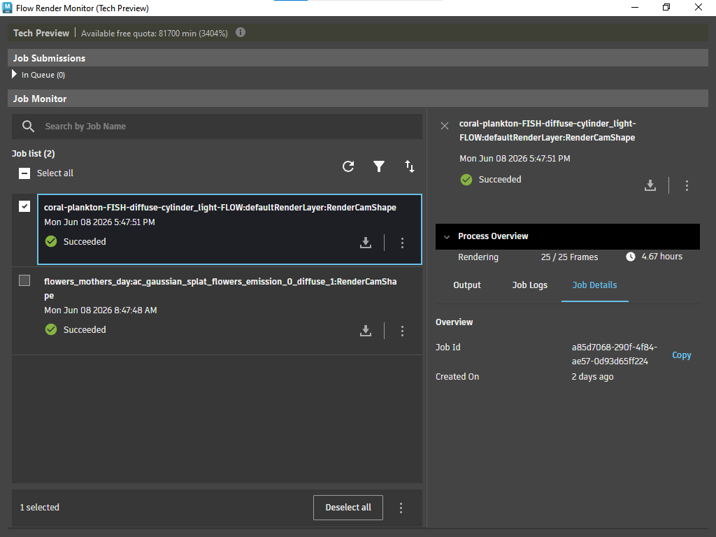

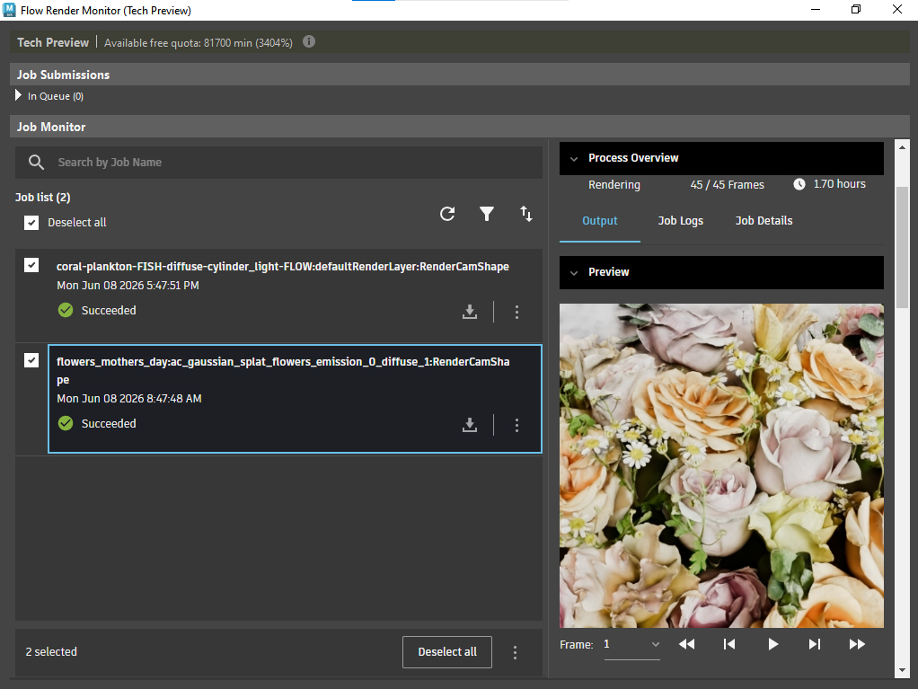

Job Monitor
This panel displays a list of submitted jobs and details of any selected job. You can search for specific jobs by name, filter the job list by job type or status and sort the jobs.
Job Details
Click a job to see a thumbnail preview of the output, the status of individual frames, and to check the Arnold render log.

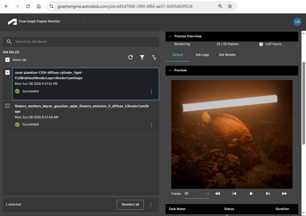

Web Interface
The job monitor can also be accessed from a web browser at https://graphengine.autodesk.com/ using your Autodesk account. No downloads are available currently from the web interface.
