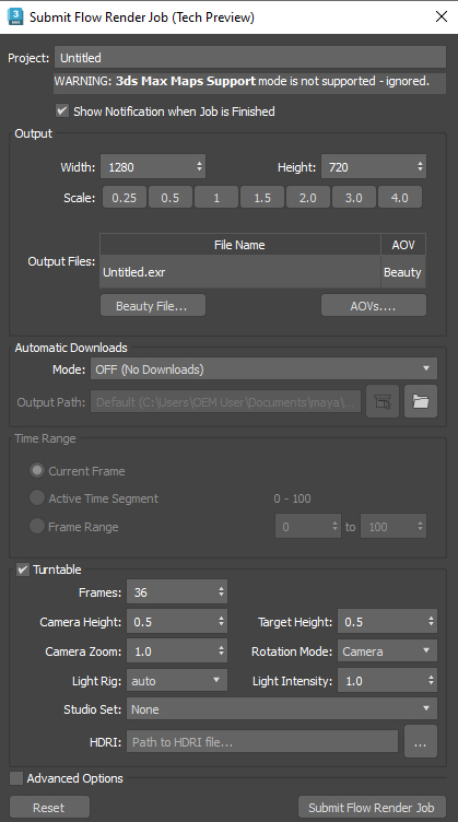

Turntable is an Advanced Option in the Flow Render Submitter window (Arnold > Flow Render > Submit Flow Render Job). Enabling it submits a turntable animation job to the Flow Render cloud service instead of a single render. For the Project, Output, Output Files, Automatic Downloads, and Time Range settings, see Flow Render Submitter.
Turntable
Enables turntable rendering for the submitted job.
Frames
Sets the total number of frames for one full 360-degree rotation of the turntable.
Camera Height
Sets the height of the turntable camera relative to the object's bounding box.
Target Height
Sets the height of the camera's look-at target relative to the object's bounding box.
Camera Zoom
Controls the zoom level of the turntable camera. Higher values move the camera closer to the subject.
Rotation Mode
Determines how the turntable animation is driven.
Light Rig
Specifies the lighting setup to use for the turntable. Defaults to Auto.
Light Intensity
Scales the overall intensity of the light rig.
Studio Set
Applies a preset studio environment to the turntable render.
HDRI
Specifies a path to an HDRI file to use for lighting the turntable.
