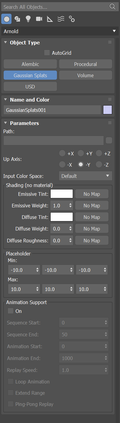

The Gaussian Splat shape loads and renders Gaussian splat datasets inside Arnold. These parameters control file loading, viewport display, color handling, and advanced rendering options.
Path
Specifies the Gaussian Splat file to load (PLY).
Up Axis
Specifies the coordinate-system convention used by the source splat file (for example, Y up or Z up). Set this to match how the splat dataset was authored so that the data is oriented correctly in the scene.
Min Pixel Width
Defines the minimum on-screen size of individual splats in pixels. Increasing the Min Pixel Width (MPW) can help reduce holes and sparse regions, improve the visibility of distant splats, and produce smoother surface reconstructions. Lower values preserve finer detail but may introduce gaps or aliasing in thin regions.
There is a global switch for Min Pixel Width available in the Render Setup window.
The Min Pixel Width parameter can also be overridden on a per-object basis using the Arnold Properties modifier.
Input Color Space
Specifies the color space used to interpret splat color data. Choose the color space that matches the source dataset to ensure accurate shading and lighting.
Shading
Controls how each splat's stored color and radiance data is interpreted, shaded, and combined into the final image.
Emission Tint
Applies a color multiplier to the emission component of each splat. White preserves the original captured color; other values shift the emitted appearance for look development, grading, or matching scene lighting.
Emission Weight
Scales the contribution of each splat's stored radiance, treating splat color as emitted light. A value of 1.0 renders splats at their captured brightness; 0.0 disables the emission contribution.
Diffuse Tint
Applies a color multiplier to the diffuse component of each splat.
Diffuse Weight
Scales the diffuse shading contribution from scene lights. Use a non-zero value to have splats respond to Arnold lights; set to 0.0 for an unshaded, radiance-only look.
Diffuse Roughness
Controls the roughness of the diffuse response. Higher values produce a flatter, more uniform diffuse falloff across each splat.
