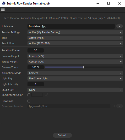

Flow Render Turntable submits a turntable animation job to the Flow Render cloud service. Open the window from Arnold > Flow Render > Submit Turntable Job.
Job Name
A descriptive name for the turntable job as it appears in the Flow Render queue. Supports tokens such as $prj for the current project name.
Render Settings
Specifies the render settings to use for the turntable job. Defaults to the currently active render setting.
Take
Specifies the Cinema 4D take to use for the turntable render. Defaults to the currently active take.
Resolution
Specifies the output resolution. Defaults to the resolution defined in the active render settings.
Rotation Frames
Sets the total number of frames for one full 360-degree rotation of the turntable.
Frames Per Task
Sets the number of frames processed in each render task. This setting can improve rendering efficiency by reducing the overhead of starting a worker and loading the scene for each task. By default, each task renders 1 frame. If your frames render quickly, increasing this value (for example, 10 or more frames per task) can reduce overhead and improve overall rendering performance. If your frames take longer to render, the default value of 1 is typically recommended.
For example, rendering a 100 frame turntable with 10 frames per task produces 10 tasks that run in parallel on 10 Flow Render worker machines (10 being the maximum number of parallel tasks on Flow).
Camera Height
Sets the height of the turntable camera relative to the object's bounding box. Available presets are Top, Center, and Bottom.
Target Height
Sets the height of the camera's look-at target relative to the object's bounding box. Available presets are Top, Center, and Bottom.
Camera Zoom
Controls the zoom level of the turntable camera as a percentage. Higher values move the camera closer to the subject.
Animation Mode
Determines how the turntable animation is driven.
Light Rig
Specifies the lighting setup to use for the turntable.
Light Intensity
Scales the overall intensity of the light rig.
Studio Set
Applies a preset studio environment to the turntable render.
Background Color
When enabled, overrides the background with a solid color. Use the color swatch to set the color.
Download
Enable automatically downloading render outputs to the specified folder, assuming Cinema 4D is still running when the job is finished.
You can use some specific tokens in the path, besides the standard Cinema 4D tokens:
Note:
Using the same folder for local renders and download (for example, $prjsavedir) is not recommended, because then Flow Render outputs silently overwrite your local renders.
Advanced
Force Upload Missing Files
Forces re-upload of scene files, even if they were uploaded previously. Use this if the render fails due to missing assets, or when you suspect the local resource cache no longer reflects the true state of the server (for example, after working on a different machine or after a long time since the last submission).
