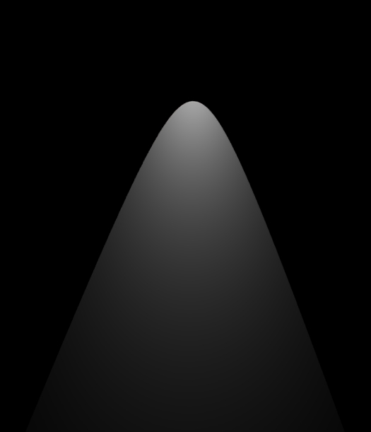

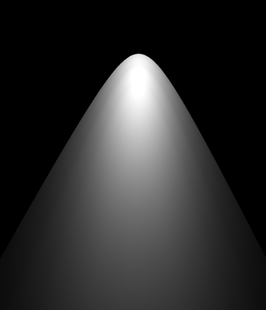

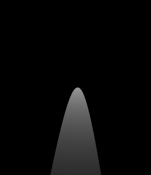

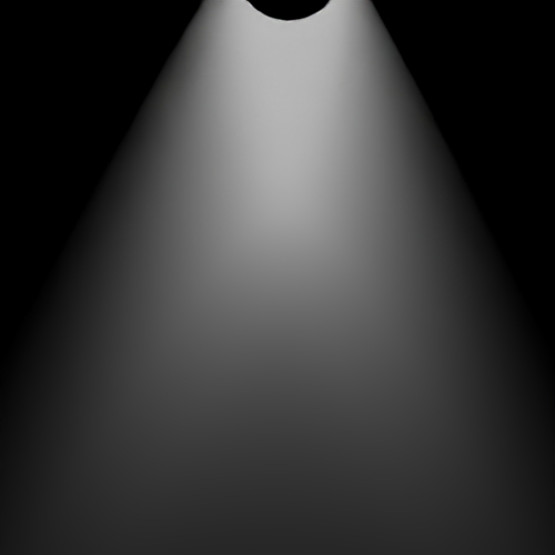

Cone Shaping on Non-Sphere Lights
Cone angle and softness support for cylinder, disk, quad, and mesh lights, with focus and focus tint effects. Extended cone angles up to 180 degrees, with per-ray evaluation for accurate spotlight behavior.
Cone Angle
10
20
30

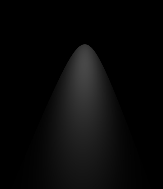

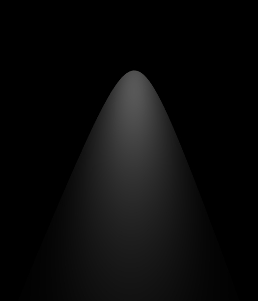

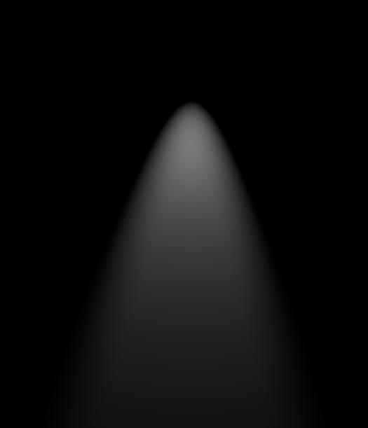

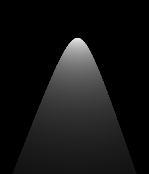

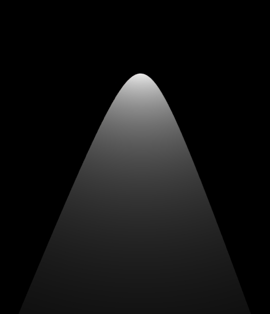

Cone Softness
0
0.5
1

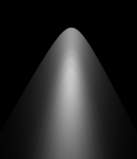

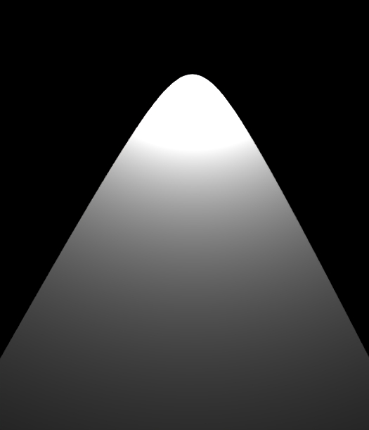

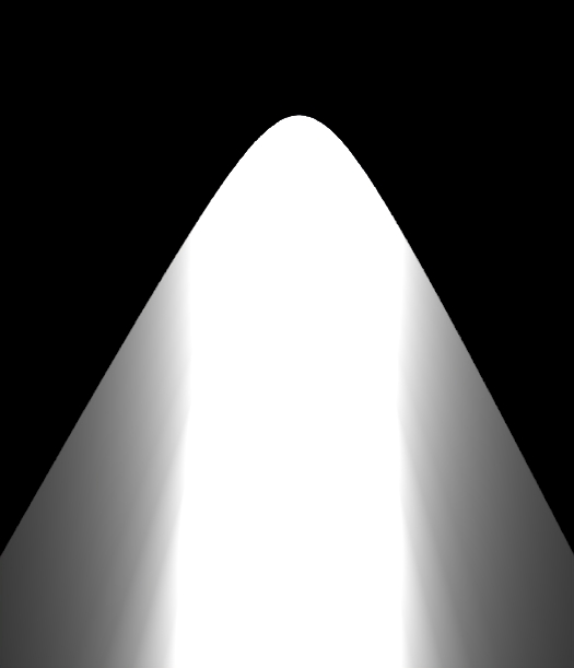

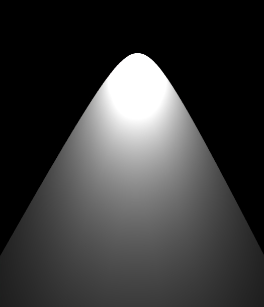

Shaping Focus
0
10
20
30
40
50

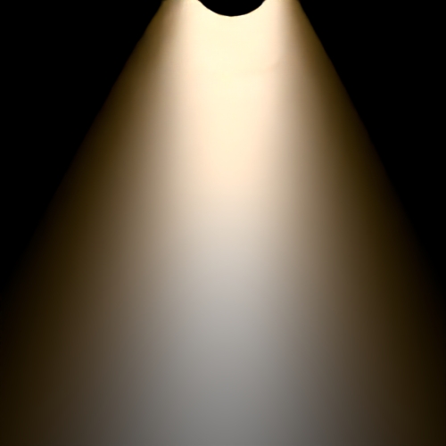

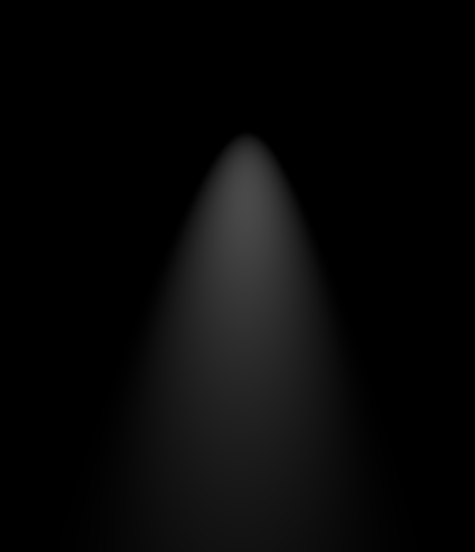

Shaping Focus Tint
White
Color

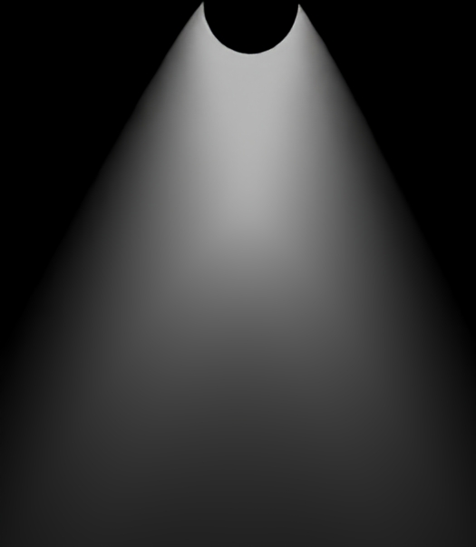

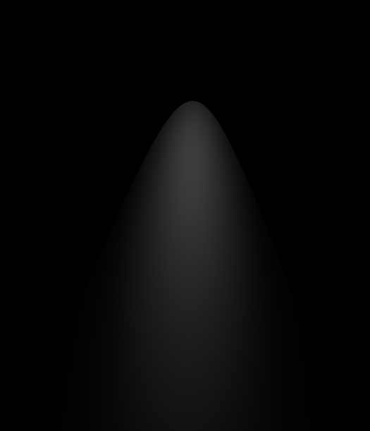

IES Profile Extensions
IES Filename
IES Angle Scale
Rescaling of IES profile angular distribution.
0
2
3
IES Normalization
Normalizes IES profile intensity by integrating over solid angle.
0
1

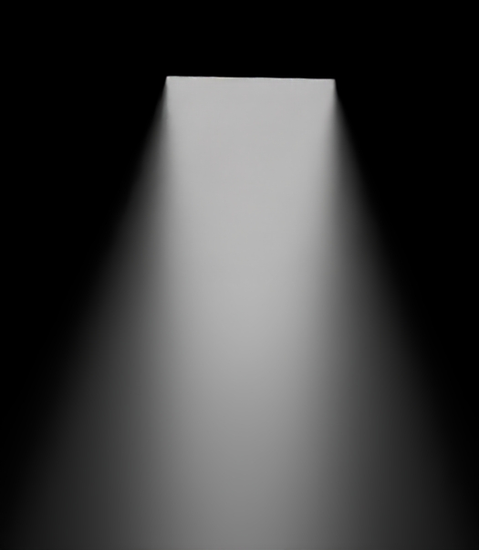

IES on Non-Sphere Lights
IES profiles on cylinder, disk, quad, and mesh lights.
Sphere
Cylinder
